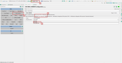

Step 2: Addressing the First Error
  1. After building the project, you encountered an error related to BMS_Common.
  2. After following the MCAL code generation steps, an error occurred while building the project
 To fix this, we updated the bms_common component by choosing the correct driver.
  • Screenshot:

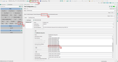

Step 3: Fixing Communication with Freemaster
  1. There was an issue with FreeMASTER communication after investigating. We had to change the baud rate to establish communication with FreeMASTER
  2. Adjust the baud rate settings to ensure proper communication.
