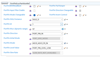

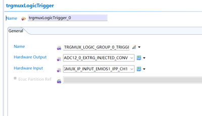

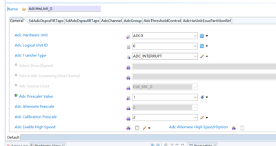

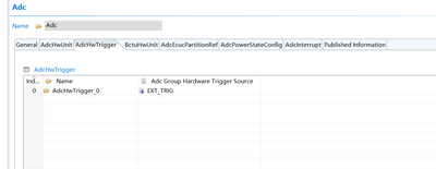

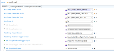

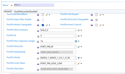

I am using the chip s32k344 and want to use the external rising edge to trigger ADC sampling by configuring trgmux and adc.
ADC port and trgmux port
drfrefw123_3-1706253510644.pngdrfrefw123_4-1706253523961.pngdrfrefw123_5-1706253537848.pngdrfrefw123_6-1706253593394.pngdrfrefw123_7-1706253611763.png

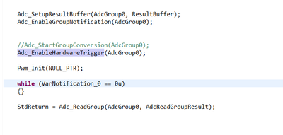

The external pwm is injected into the I/O port,But the program can't get in Notification
993 Views
PetrS
eMIOS input cannot be selected as TRGMUX source, just eMIOS output.
Try to configure PTC11 for TRGMUX_IN10 functionality and config TRGMUX to select this TRGMUX_IN10 as input source for ADC external trigger.
