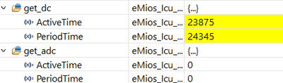

I am not sure if I am missing something here, but I replicated this with three different emios channels, and I have issues with input capture in EMIOS2.
When I attempt to use signal capture on my board (S32K358EVB-Q289 Rev A), I am unable to get duty cycle or edge trigger response using EMIOS_ICU only when configured to EMIOS 2. Works fine for EMIOS 0 and EMIOS 1.

There is no any errata for EMIOS with the S32K358.
Could you please make a double check in your board to see if you need to populate or depopulate a 0 ohm resistor in order to enable in the arduino connectors?
