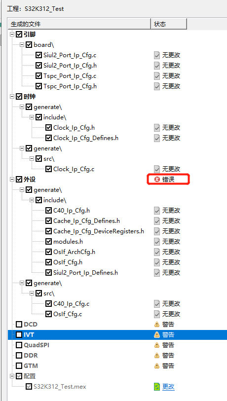

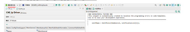

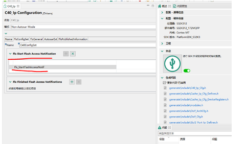

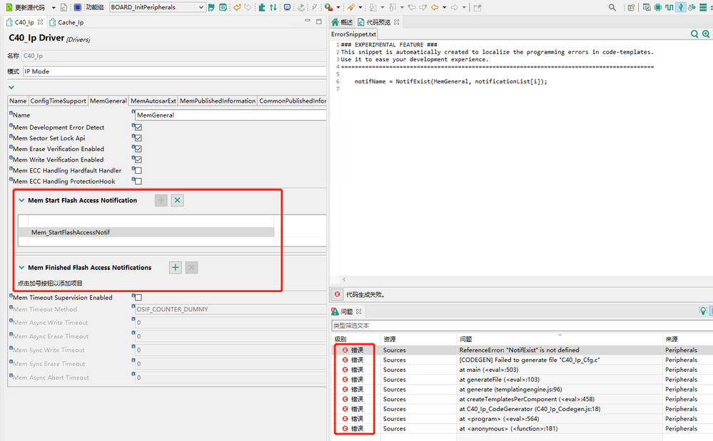

I am currently working on a project involving the S32K312 chip and using S32DS for configuring the Flash.
Errors occurred after configuring the "Mem Start Flash Access Notification" parameter for S32K312.
Could anyone please provide some guidance or advice on how to configure and use the "Mem Start Flash Access Notification" parameter correctly?

RogerFranca
Hi!
I have the same problem, but I already have a large part of my application developed and changing RTDs would not be ideal.
Would there be any explanation to solve the C40 problem with the RTD setup in the first image published in this topic?

Chris-Sun
Hi @Senlent
Thank you for your response to my post.
I tried to update the code, but there are still errors.
Attached is the project I used.
Chris

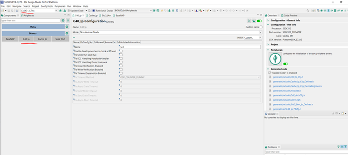

Senlent
Hi@Chris-Sun
I imported the project you provided, and the interface displayed is a little different.
however I didn't find any problems.
3,239 Views
Chris-Sun
Hi @Senlent
According to the screenshot you provided, the configuration pages for C40 are different, and the "Mem Start Flash Access Notification" configuration option is missing. (The error I encountered during configuration might be caused by this option.)
Is it possible that we are using different versions?
The version information:
S32DS: 3.5
RTD: S32K3_RTD_3_0_0_D2303_ASR_REL_4_7_REV_0000_20230331
Chris

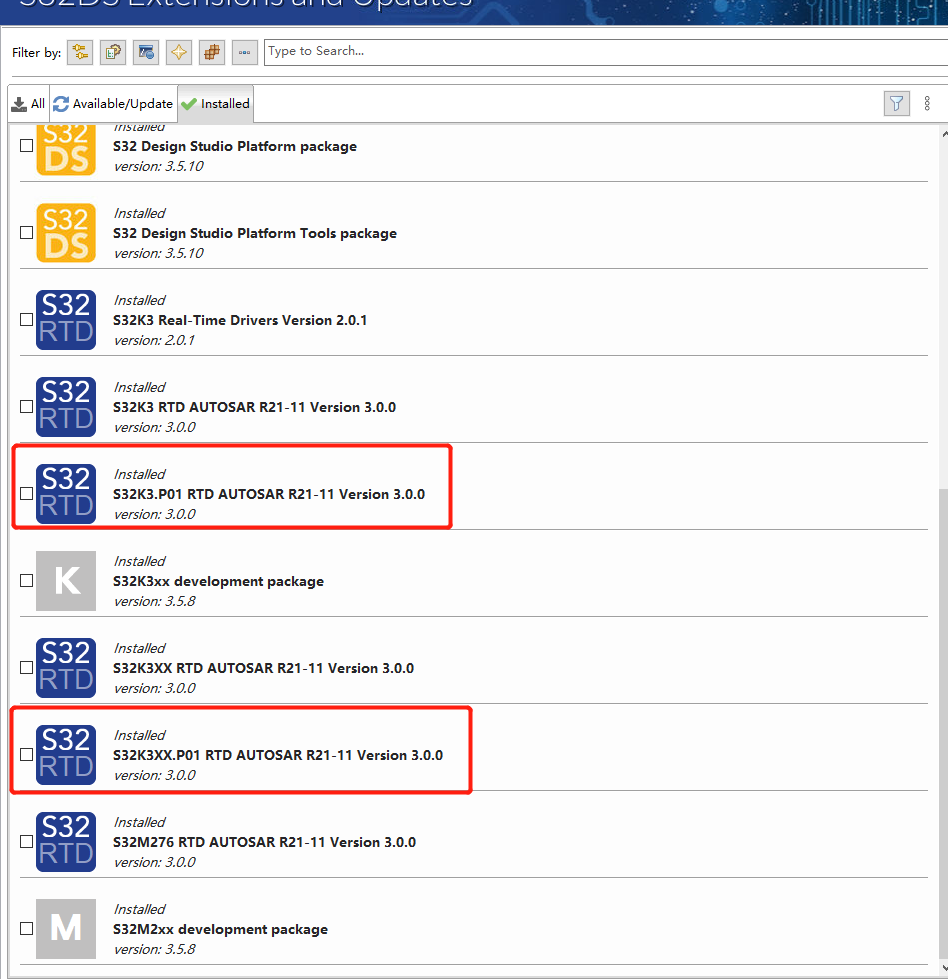

Senlent
Hi@Chris-Sun

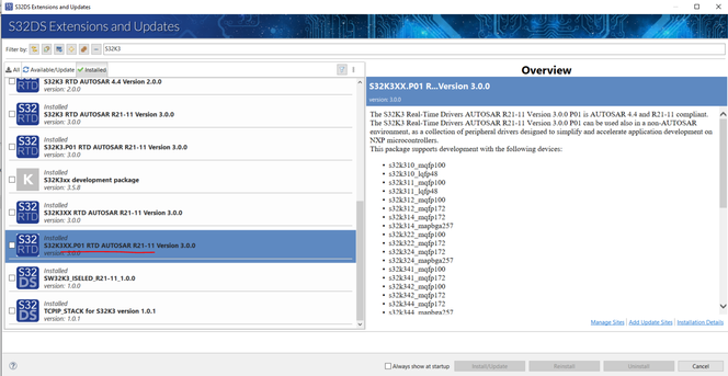

Can you try installing this version
There are many versions of RTD 3.0.0, and I can't adapt to all of them on my computer at the same time.
3,153 Views

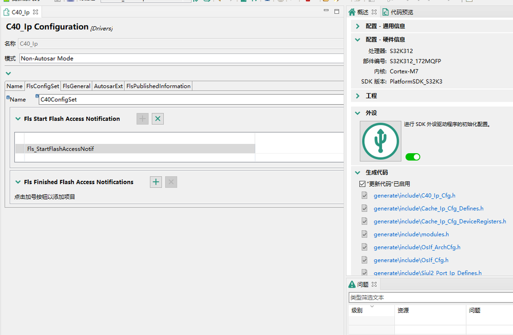

Chris-Sun
Hi @Senlent
After using the RTD version you mentioned earlier, I no longer receive any errors, and the graphical interface of the configuration item has also changed.
Does this imply that only specific version RTD support the "Mem Start Flash Access Notification" configuration?

Senlent
Hi@Chris-Sun
 I think "Mem Start Flash Access Notification" is just same with the below highlight part.
3,143 Views
Chris-Sun
Yes.
What I mean is, previously when I used the following RTD version and configured "Mem Start Flash Access Notification", it resulted in many errors (as shown in the image I added earlier).
Then I installed this version of RTD and configured "Mem Start Flash Access Notification", and there were no errors. Additionally, the graphical interface of the configuration has changed.
From this, can we conclude that the configuration of "Mem Start Flash Access Notification" has issues in a certain version of RTD and works properly in other versions?
