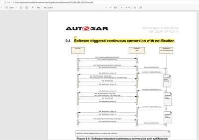

I want to implement continuous conversion mode of ADC peripheral using S32K144 MCU, using Autosar MCAL layer.  Particularly this scenario:

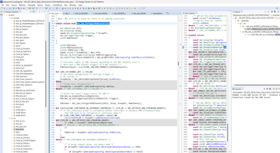

And what i found that in NXP MCAL layer for ADC module, we can configure Continous ADC conversion mode either in case of non interrupts or in case of DMA:
So does it mean, we cant use ADC continuous conversion mode with Interrupts??? If not then in that case how are we going to achieve the above scenario.
That scenario is from Autosar ADC MCAL specifications.

normally a SW triggered continuous conversion is possible and notification is called upon group conversion is finished.
Probably you point to Parameter AdcContinuousWithoutInterrupt which is configurable to do not call interrupt upon group conversion. See more in ADC driver manual.
BR, Petr
