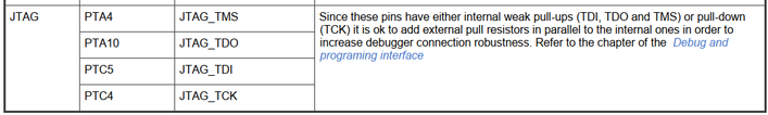

 Is there any pins pull up or pull down is required to full fill  Boot up SEQUENCE of S32K344NHT1MPBST.

Hello @pokurisatyanarayana,
From the S32K344 Hardware design guidelines:
