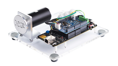

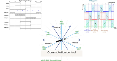

These examples demonstrate a a 3-phase Brushless DC (BLDC) motor control drive using a Six-step commutation control with Hall position sensor and without any position sensor (sensorless). This design serves as an example of motor control design using NXP S32K3 automotive family. tomasfedor_0-1707467166083.pngtomasfedor_0-1707467166083.png
Examples were designed on S32K344 Brushless Direct Current and Permanent Magnet Synchronous Motor Control Development Kit.
C-project based examples are part of MCSPTE1AK344 Development Kit Application Software. An innovative drivers set, Real-Time Drivers (RTD),are used to configure and control the MCU. It complies with Automotive-SPICE, ISO 26262, ISO 9001 and IATF 16949. Production-ready Automotive Math and Motor Control Library set provides essential building blocks for algorithm. FreeMASTER is used as useful run-time debugging tool.
Application software contains:
  • MCSPTE1AK344_BLDC_6Step_hall_ll-. Hall sensor-based example. Detailed description of the example can be found in attachment to this article MCSPTE1AK344 - 6-step hall.pdf.
  • MCSPTE1AK344_BLDC_6Step_sensorless_ll – Sensorless based example. Detailed description of the example can be found in attachment to this article MCSPTE1AK344_- 6-step sensorless.pdf.
MATLAB Simulink based project (Motor Control BLDC Example - s32k344_mc_bldc_ebt) is build using Model-Based Design Toolbox (MBDT) and can be downloaded from NXP Model-Based Design Toolbox for S32K3xx - version 1.4.0 or newer releases.
