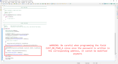

Step 1: Program the CUST_DB_PSWD_A Field
The UTEST Sector is an OTP (One Time Programmable), meaning erase operations are not allowed. You can only append or read data.
  • Memory Range: 0x1B00_0080 to 0x1B00_009
  • Only the first 16 bytes (0x1B00_0080 to 0x1B00_008F) are usable.
  • The rest is reserved (see Table 202 in the S32K3xx Reference Manual, Rev. 11).
Programming Steps:
I. Unlock the UTEST sector using PFCBLKU_SPELOCK[SLCK].
II. Write the 16-byte password to address 0x1B00_0080.
Code Adjustments:
*                                       LOCAL MACROS
#define FLS_MASTER_ID                0U
#define FLS_BUF_SIZE                 16U
#define FLS_SECTOR_ADDR              0x1B000080U
#define FLS_SECTOR_TEST              C40_UTEST_ARRAY_0_S000
NOTE: Ensure FLS_MAX_VIRTUAL_SECTOR and C40_SECTOR_ERROR are correctly defined in C40_Ip_Cfg.h:
Instead of:
#define FLS_MAX_VIRTUAL_SECTOR              (527U)
#define C40_SECTOR_ERROR                    (528U)
Use:
#define FLS_MAX_VIRTUAL_SECTOR              (528U)
#define C40_SECTOR_ERROR                    (529U)
*                                      GLOBAL CONSTANTS
uint8 TxBuffer[FLS_BUF_SIZE] = {0x01,0x02,0x03,0x04,0x05,0x06,0x07,0x08,0x09,0x0A,0x0B,0x0C,0x0D,0x0E,0x0F}; /* Password */
You can verify the password using the Memory Viewer (not covered here).

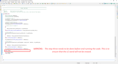

Step 2: Advance the MCU Lifecycle
I. Set the lifecycle configuration word address in the IVT/boot header. Refer to sections 32.5 and 32.5.3 of the Reference Manual.
NOTE: Ensure the structure of the boot_header (located in Project_Settings → Startup_Code → startup_cm7.s) is defined as follows:
#define LF_CONFIG_ADDR              (0x007D2000) /* The LC word can be at any flash address, taking care that does not interfere with HSE */
II. Write the LC word to the defined address:
Life cycle stage Valid Values for LC Advancement
OEM_PROD DADA_DADAh
IN_FIELD BABA_BABAh
Code Adjustments:
*                                       LOCAL MACROS
#define FLS_BUF_SIZE                 8U
#define FLS_SECTOR_ADDR              0x007D2000U
#define FLS_SECTOR_TEST              C40_CODE_ARRAY_0_BLOCK_3_S489 /* Look into C40_Ip_Cfg.h file to find the corresponding sector */
*                                      GLOBAL CONSTANTS
uint8 LC_TxBuffer[FLS_LC_SIZE] = {0xDA, 0xDA, 0xDA, 0xDA, 0x0, 0x0, 0x0, 0x0}; /* Minimum data length 8 bytes */
Confirm the LC word using the Memory Viewer.
III. Reset the MCU using the RESET_B pin, not the debugger.
