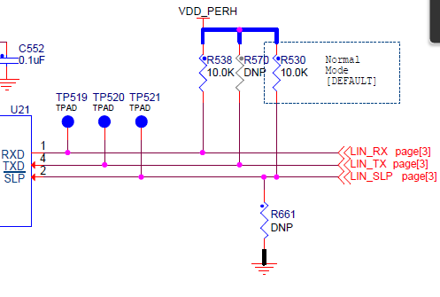

Hi Petr ,
You had used PTD5 as LIN sleep enable pin, but in schematic S32K116 EVB-Q048 LIN transrecevier sleep pin is pulled up to +ve .
Hi Yogish,
yes, if you do not need to control SLP pin then you need not to configure PTD5.
BR, Petr
