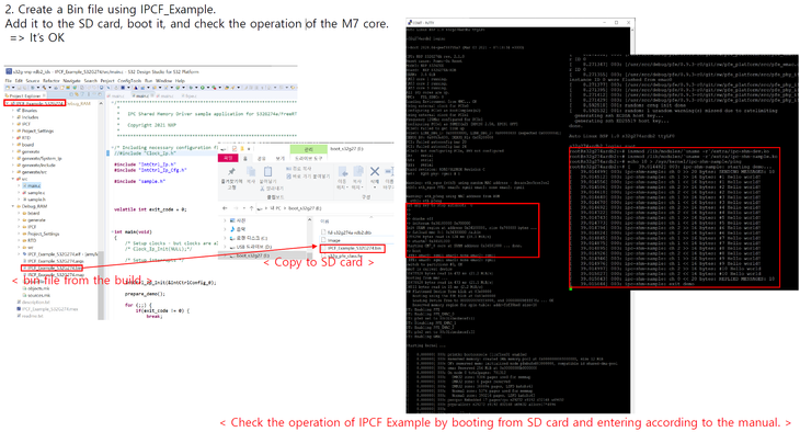

hi youngdae, so you can do the IPCF example integration without problem right?
for LLCE CAN, have you checked the CAN gateway project listed in GoldVIP? here we provided the Autocore (ASR OS) + configurations, you just need to follow the UM chapter 10 to try it.
GPT is a module covered by RTD which should have been used to build CAN gateway application.
for integration you might refer to the Integration reference examples.
for boot flow, you could refer to UM chapter 6 for more details. and there is a GoldVIP get started video available here covered.

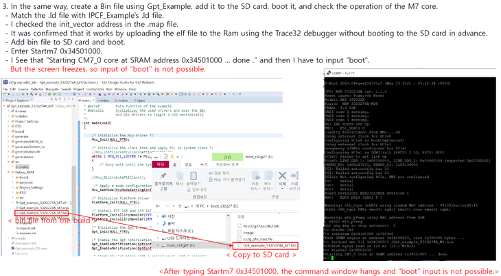

Hello, I am running into the same issue where the IPCF example works. But when I try to start my own M7 app from u-boot, the app starts, but u-boot stops working after that.
Why does this happen?
How can I boot all 3 real timer clusters as well as Linux in the A53 cores? Why is there such little guidance as to how to do this. You keep referring us to documentation that is incomplete, very superficial, and has examples that don't use all the cores.
How can we boot Linux on the A53 cores, and 3 different applications in the cortex-M7 cores? Please don't refer me to the documentation, I've read ALL of it, and there's no information on how to do this.
If you could at least describe what the boot process is? Like should I do this from u-boot? from Linux? From a cortex-M7 core?
ANY guidance is much much appreciated.

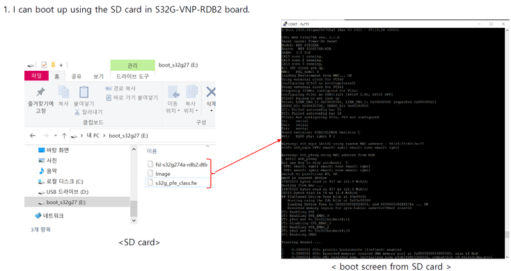

youngdae
Thank you for reply.
It works well in Linux environment by putting the bin file produced by building the IPCF shared memory example in S32DS into the SD card.
The problem is that it is not IPCF shared memory, but it does not work in Linux environment by putting the bin file of another example project in the SD card.
example) LLCE CAN, GPT (General Timer), and so on.
Please check the attached file.
