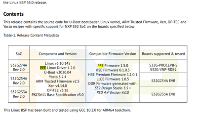

What is the compatible pfe firmware version of bsp35?

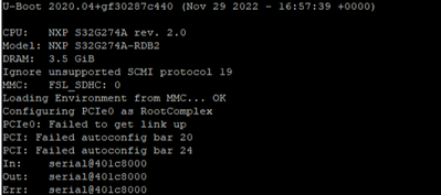

We are using bsp35 and pfe1.5. It depends on release note:
There is a error as seen below?

For BSP35.0, PFE-FW v1.5.0 is the one compatible with. For the log that you are showing, we see that the u-boot version is a newer one than the one we have under our BSP35.0 image:
For which we assume you are building your own image. How are you building your image? Can you confirm which version you are building?

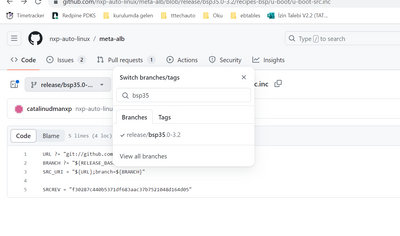

irfank
We compile our image by yocto.
Start commit of our  Uboot code  is https://github.com/nxp-auto-linux/u-boot/commit/f30287c440b5371df683aac37b7521048d164d05.  then we update it depends on our board.
If we use same uboot code under bsp33 with pfe1.3. It is ok.
But If we use this uboot code with bsp35 with pfe1.5. We have the above error.
If we use this uboot with bsp35 with pfe1.3 . uboot is bring up, but pfe is not connect network.
