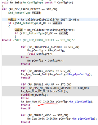

I am configuring the MPU_M7 under the RM, not XRDC. I think I am not initializing it properly. How can this be achieved?

Thanks for your feedback. Are you using any NXP example? If not, can you reproduce the behavior under an NXP example?
In which RTD version are you working on?
We understand that, if configured correctly, the Rm_Init function should configure the MPU itself:
Please, let us know.
