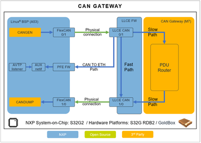

Also, I tried to modified the CAN-GW project, by changing the LLCE_CAN controller and relative PortPin configuration (figure shown below), in order to compare with my own M7 App. And I found that some hardware controller would failed to send/receive (e.g. BCAN12), while others (e.g. BCAN6, BCAN14) would work. Are there any possible explanation for this?

For the CAN-GW project, I tested with the exact same use case demonstrated in the GoldVIP documents, where some scripts (e.g. can-slow-path.sh) are executed on A53 to generated CAN frames passing to M7 and calculate network statics. The only difference is that LLCE CanController_1 changes from BCAN1 to others. When using BCAN12, the networks statics indicated 100% lost frame.
Since other BCANs are confirmed to work (no lost frames) when testing with the same condition, I don't really think it's a configuration problem. Anyway, Here's some configurations I changed (or confirmed):
    Port: Add PortPins for LLCE_CAN12_TX/RX
    Mcu: no need to change, since all LLCE CAN channels used the same clock source
    Os: no need to change, since all interrupts for LLCE are already configured
Besides, I have already tested RTD + LLCE examples before, all LLCE CAN channels was confirmed to work when running only M7 core. This problem only happens in CAN-GW, so I suspect this has something to do with the integration with A53 side?

There is a limitation known on the LLCE module that says the following [Page 13, LLCE Firmware User Guide, v1.0.4]:
"When using multiple hosts, each of them can have maximum 8 channels assigned, and the allocation must be done in 2 distinct groups: channels 0-7 for Host0 and channels 8-15 for Host1. Each of this split is called "Host Interface" (HIF). This restricted allocation comes from the interrupt routing of the FIFOs used as interface between LLCE firmware and CAN driver, which shares the same interrupt line along 8 FIFOs."
Seems odd that you are able to map without this restriction until arriving to BCAN12, but again, the above is a known limitation of the provided LLCE Firmware.
