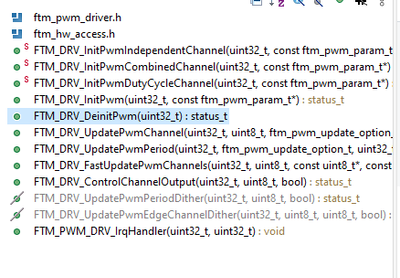

I want to generate 2 pwm signals with a 90/180 degree shift between them. I am using s32k144 and the Timer module FTM1 with edge aligned mode.
- Should i use combined channel configuration or independent channel configuration?
- if both work how can i realise the phase shift with both configurations?
(I could barely find any documentaion with SDK )

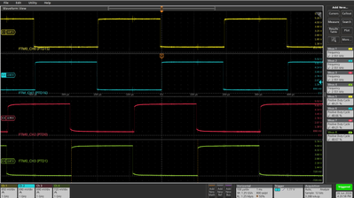

I share with you a demo that perform the modified combined and complementary modes for phase shift and with dead time insertion. It look like this:
I attach the project using S32 Design Studio for S32 Platform v.3.5 and RTD for S32K1 and S32M24x version 2.0.0 including patch P01.
Hope it helps you.
Have a nice day!

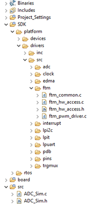

snow3847
Thank you for the reply .
From the Project that you sent me i can see that we don't have the same SDK. i have SDK 4.0.1 for S32 DS which looks like this :
160 Views
_Leo_
There is also as reference the AN5303: Features and Operation Modes of FlexTimer Module on S32K and to its respective associated file AN5303SW.
