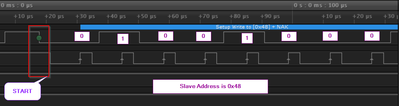

MohitManvar
hello,
Find this helpful to you
4,532件の閲覧回数

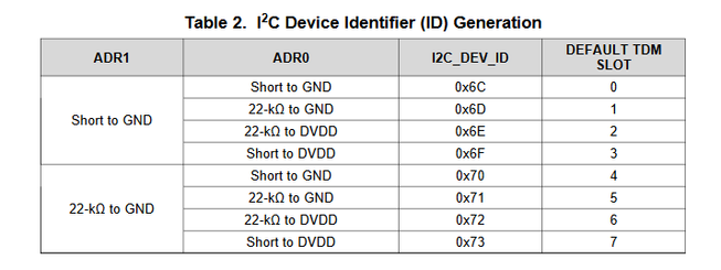

danielmartynek
0x48 is not an address of the chip:
https://www.ti.com/lit/ds/symlink/tas5720l.pdf?ts=1690775518844&ref_url=https%253A%252F%252Fwww.ti.c...
BR, Daniel
4,522件の閲覧回数
MohitManvar
i used 0x6C as address this is only snap of I have  from other slave device.
Please consider 6c as address and provide solution
Thanks!!

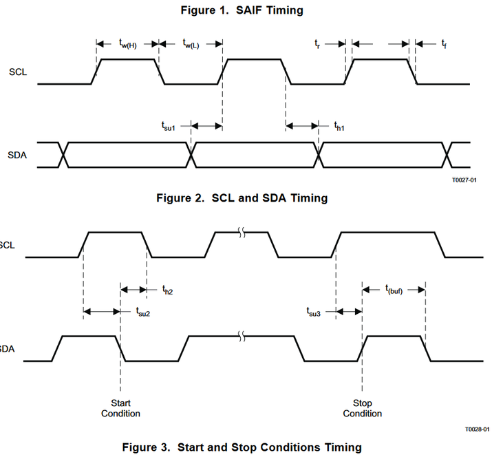

danielmartynek
Hello @MohitManvar,
Does it mean the waveform you posted shows a completely different communication?
It is hard to say what is wrong if you do not measure the signals.
The satasheet of the slave device specifies the required I2C format and timimng.

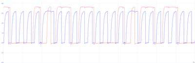

MohitManvar
Hello @danielmartynek
please find below snap for your reference
slave address : 0x6C
slave speed: 100kbps
blue:SCL   ,   Red:SDA
Br,
Mohit

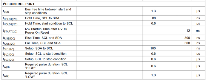

danielmartynek
The address is correct assuming correct HW configuration.
7 MSB 0x6C
0xD8 for a write.
Why is the volatage of the SDA signal higher that SCL?
The datasheet of the slave device specifies the I2C.
Can you double-check the timing?
