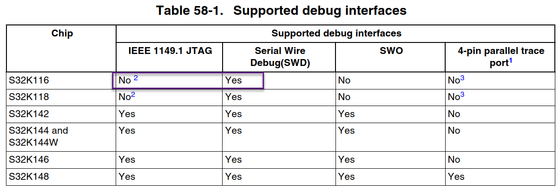

     Besides, when I use S32DS to debugging the S32K116, the RCM_SRS value is correct, but if use the Trace32, it only shows 0x400. The trace32''s interface is SWD, and in S32DS, interface is PE micro.
      By the way, I read in the manual that the S32K116 is not supported SWD or JTAG, will this have any impact?
  Table 53-1. Supported debug interfaces
Chip Supported debug interfaces
IEEE 1149.1 JTAG Serial Wire
Debug(SWD)
SWO 4-pin parallel trace
port
1
S32K142 Yes Yes Yes No
S32K146 Yes Yes Yes No
S32K144 Yes Yes Yes No
S32K148 Yes Yes Yes Yes
from < S32K1xx Series Reference Manual>  Document Number: S32K1XXRM
Rev. 4, 06/2017
BR, GGbong
20,888 Views
danielmartynek
Hi @GGbong,
You use an old version of the RM.
SWD is supported on S32K116.
Can you please contact Lauterbach support?
