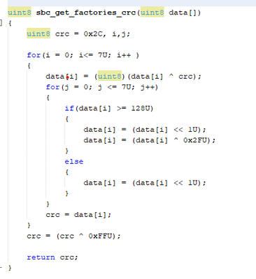

and I am using the CRC algorithm provided in the datasheet:
I am getting the CRC as 0x26, is this correct (valid CRC)?

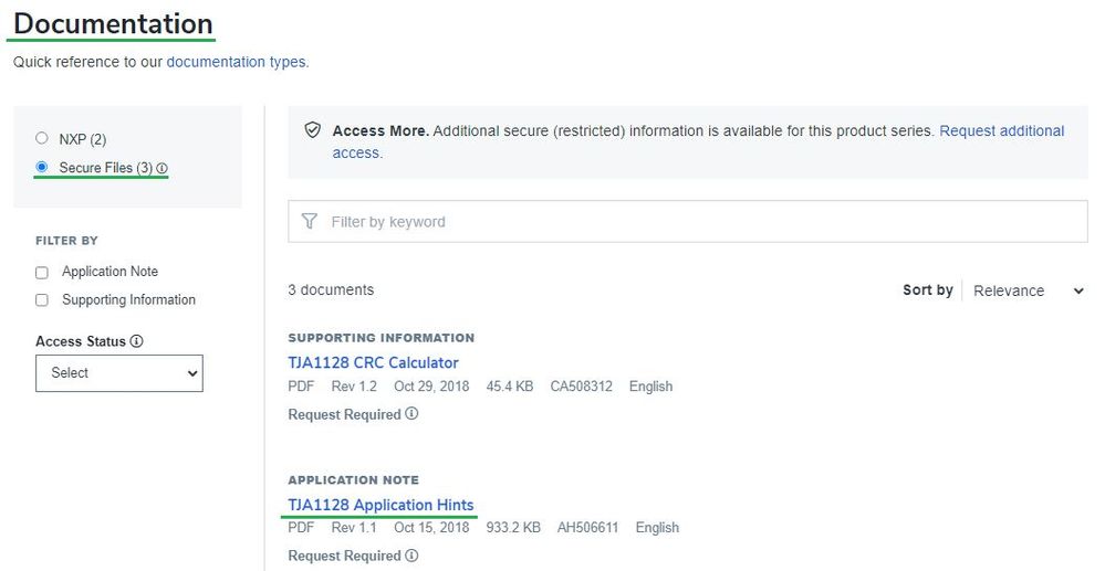

I would recommend you to take a closer look at our design resources available on the TJA1128 product website, mainly:
1. AH1801: Application Hints - TJA1128 LIN Mini System Basis Chip Family, especially Chapter 10. Software Flow

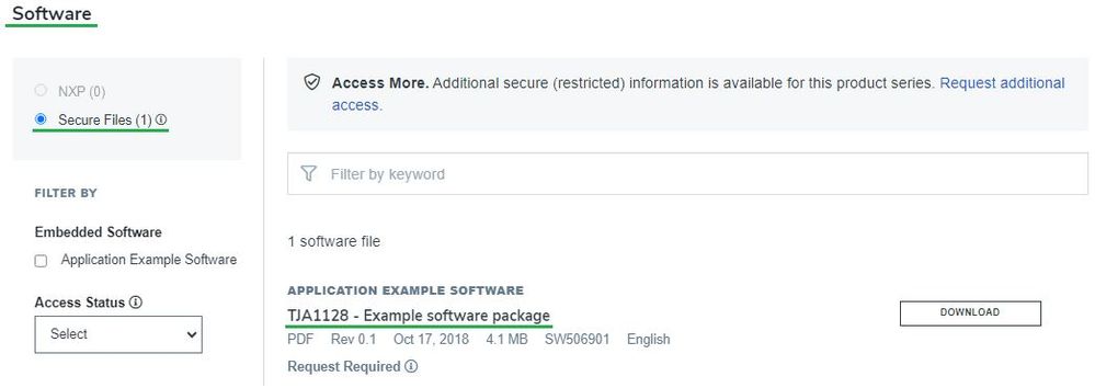

2. TJA1128 Software example
As for the CRC, there is the calculator available in the Documentation section as shown above.
