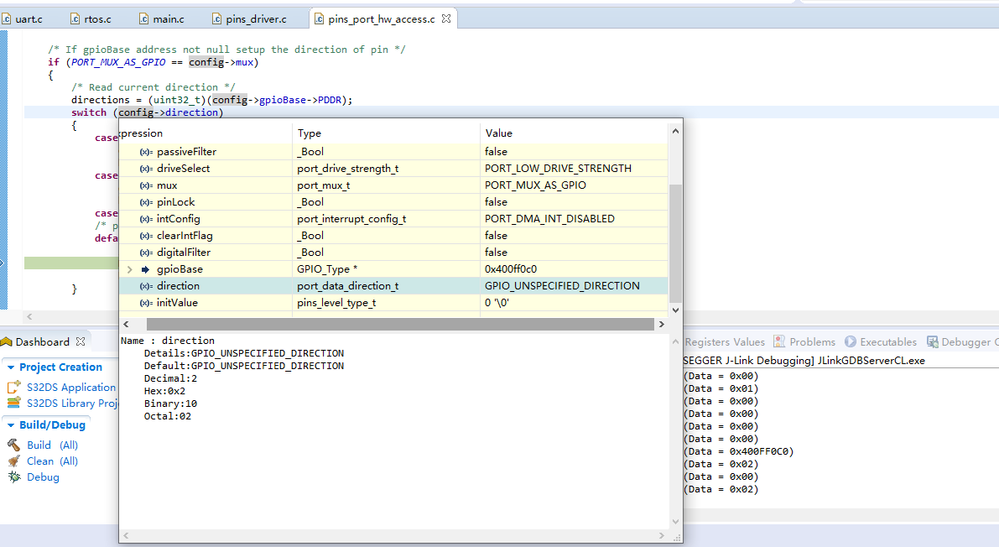

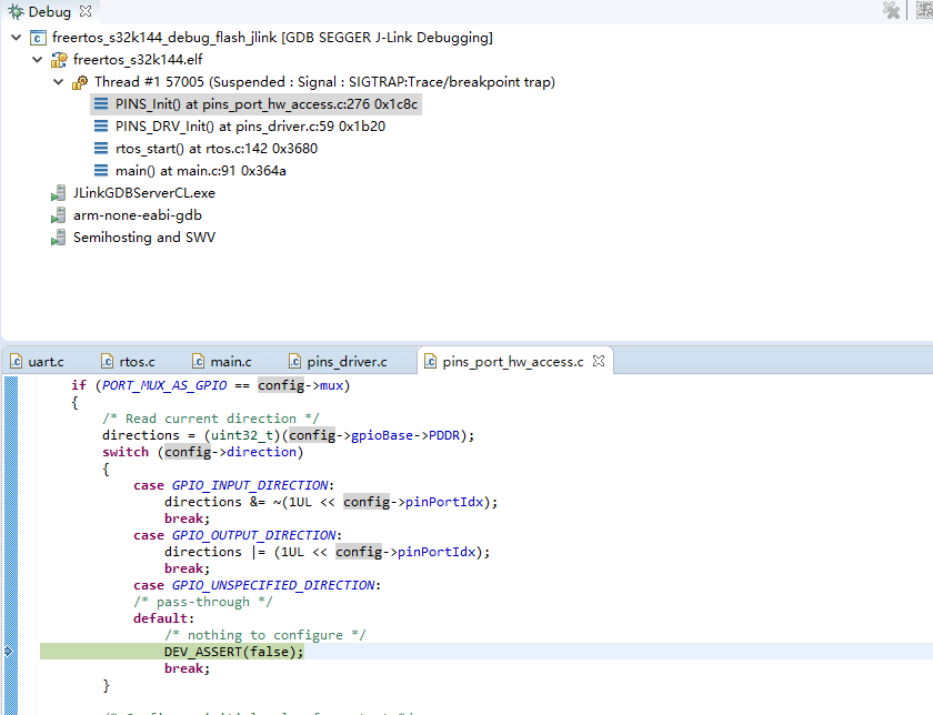

Hi,I got some Trouble in use function PINS_DRV_Init().
I opened a example Project called freertos_s32k144, when i configued pin mux and generate code automaticly,Then i called function PINS_DRV_Init() and debug the program , there are a assert occured:
It seems not none in the structure
There is my code:

Hi @geekfuns,
The g_pin_mux_InitConfigArr0 struct is generated by the CT.
Is it set correctly in the GUI?
