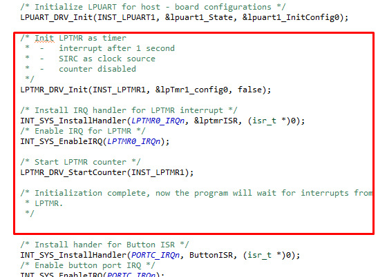

The main contains LPTIMER initialization:

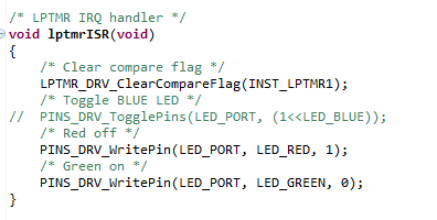

And LPTIMER interrupt routine:

When you load code into MCU, the LED should be GREEN. When you use any serial terminal and switch mode to any STOP mode like VLPS, the LED become RED.
The LPTIMER event every 10s wake-ups MCU from stop mode and change LED from RED to GREEN.
