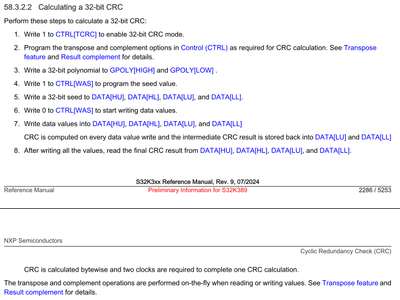

I am trying to perform a startup CRC check on Pflash contents. I have a total of 1616KB data in Pflash and for the CRC check I am planning to use hardware CRC module of the board. To perform this, I am planning to configure a DMA channel which would transfer the contents from Pflash in blocks. Transferring 4bytes of data at a time to the Data Register of CRC Engine. Since, the maximum content the destination can hold is 32bits (Data Register). Hence the transfer size that would be configured would be 4bytes at a time. I have also read; the CRC engine places the calculated CRC results also in the Data register.
My doubts here are:
1. Will a data register update alone trigger a CRC calculation? Or should any driver API to be called for CRC calculation to begin
2. If both data and CRC calculated contents are placed in the data register, how is the CRC result not overwritten by the continuous data written by DMA to data register?
Any input would be helpful.

Hi @soniyajchand
yes, it's that simple. The write itself triggers the calculation. No other actions are needed. You can take a look at this thread:
https://community.nxp.com/t5/S32K/S32K148-Is-it-possible-to-use-DMA-for-CRC-Calculation/m-p/1196173
It's still the same like on mentioned S32K1 and MPC5 devices. You can take a look at the mentioned example.
And it corresponds to the functional description in the reference manual:
Lukas
