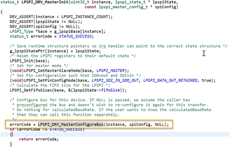

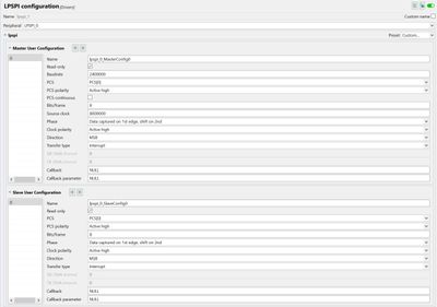

I'm trying to configure LPSPI0 master to transmit at 4,8MBaudrate in RUN mode, but I have some issues that I explain below. I'm working with the s32k148 EVB and S32DS IDE (Version 3.4).
First of all I try to set LPSPI0 master at 2,4MBaudrate. The applied settings can be seen in the following images.
When I check it in oscilloscope it seems that the transmitted frame contains the correct information I wanted to send, but at a lower baud rate than I set. The actual baud rate being applied is 2MBaudrate.

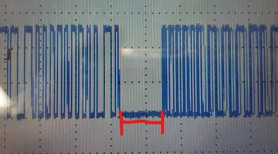

Then I try to set LPSPI0 at 4,8MBaudrate with LPSPI0_CLK_SEL = 24MHz (FIRCDIV2 / 2). When I check it in oscilloscope the sent frame was altered and the baud rate of the transmission was lower than that set (4MBaudrate).
I seem to be applying incorrect settings to the LPSPI source clock but I don't see what's going on. Any suggestion?

Hi@FBS
take a look at the function : LPSPI_SetBaudRate();
this function takes in the desired baud rate and calculates the nearset possible baud rate,and retures the calculated baud rate in bits-per-second.
in other words, this function will change the set baudrate to the nearset possible baud rate.
BR!

But there’s still one thing I don’t understand. When I set LPSPI0 at 4,8MBaudrate with LPSPI0_CLK_SEL = 24MHz (FIRCDIV2 / 2), there seems to be a pause in the middle of the 4 bytes I’m sending.
Then I tried to sending the same frame with the same baud rate but switching to to HSRUN mode. This pause disappears, do you know what it might be due to?

        I haven't had this problem before, but  I feel that it has something to do with the clock configuration of some modules. Without more information, I can't judge the possible reasons.can you tell me which routine you use?
