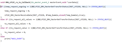

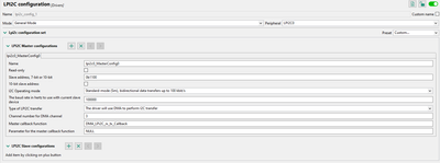

I am trying to use the LPI2C with DMA but i have the problem that it sometimes goes inside of my callback function that i use in the master configuration and sometimes not. I need to reboot the Board for it to work again. The sending and recieving seems to be inconsistent for the DMA request bit will only be enabled if the sending/receiving is completed so sometimes the callback will be ignored in the same debug session.
(the inconsistant behaviour is also present with the blocking version but after reboot i can read my temperature sensor and by Non blocking i receive false values).

I already tried non blocking and it works fine. I need the DMA version now. DMA works now but after a defined period of time the Data line is low in the picoscope and i need to reboot for it to be high again and working. any idea why?

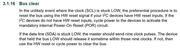

This is probably the Slave device that holds the bus low.
UM10204 I2C-bus specification and user manual
https://assets.nexperia.com/documents/user-manual/UM10204.pdf
AN4803 I2C Non-Blocking Communication
https://www.nxp.com/docs/en/application-note/AN4803.pdf

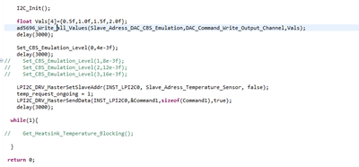

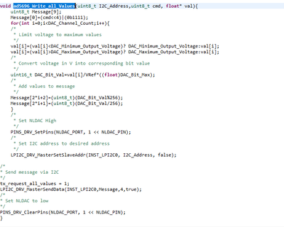

I am trying now to handle multiple slaves on the same bus but it not working for me so far. i cannot read the temperature anymore.Can you expalin how are multiple slaves are handled at the same time . And here is my updated code :
