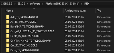

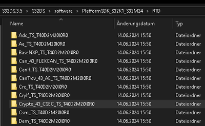

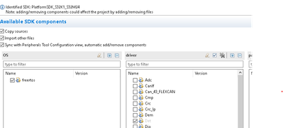

I was checking the ConfigTool but realized that there is no CSEc driver available, which can be seen in the images below
ConfigTools (RTD, AR v4.4.0, SW 1.0.0)
ConfigTools (RTD, AR v4.7.0, SW 2.0.0)

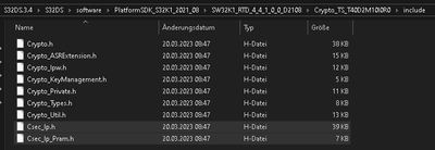

I have checked the folder of both RTDs and verified that the folder below that features the required header files in the include folder
is missing in the new RTD folder structure (no Crypto_... folder)

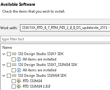

Since I use a MCU from the S32K1xx family I have downloaded the zip folder
  • S32K1_S32M24x_RTD_R21-11_2.0.0_P03_CD01_D2312_DS_Updatesite.zip
and installed it offline inside the S32DS
  • S32DS --> Help --> Install New Software...
    • Add --> Archive
      • Select previously downloaded zip folder
I have installed the first two entries and then the Crypto driver appeared in the ConfigTool list and inside the RTD folder
