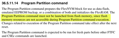

Hi @SAnjal
The partition command must be executed from RAM memory. You need to ensure that the flash is not accessed during partitioning (disabled interrupts, callback function in RAM...):
 And be aware of other restrictions related to flash, emulated eeprom and CSEc:

We have take care to run Partitioning command from RAM but, still facing this issue. As per observation,
PC is not jumping to RAM to execute the Program Partitioning command.
Note: As per current implementation we have optimized our code to level 01, does this might be creating the issue. If yes, then what care should we take for FlexRAM partitioning.

How do you force the function to RAM?
