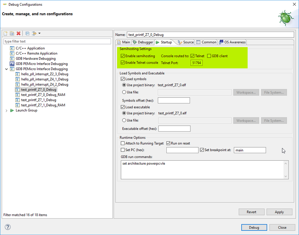

Can someone help with example function for MPC5777C controller using s32 design studio?
vrushali
3,611 Views
jiri_kral
if you need printf for debug purposes - you can use for example ewl_c library with Debugger console:
In debug settings enable semihosting:
You can see the print output in debug session console.

harsha_jakkamkr
Works like a charm.
Thanks!
