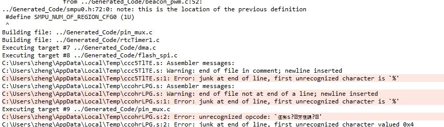

Why is the temp file used at compile time by S32 Design Studio IDE
And the temporary file is causing me to have problems with build
Why does this error occur and how to fix it

When I bulid, the console error message is as follows:

The GCC compiler uses temp file while converting from .c to .s
You can use -save-temps option while compiling to analyze the temporary files :
https://stackoverflow.com/questions/39344183/gcc-save-temporary-output-with-extra-information
I guess, It seems something wrong with system language (I might be wrong).
Please let us know if you find anything analyzing the temp files.
Also, is if possible you can switch to latest version of the S32DS, that may help to solve the issues in your development.
