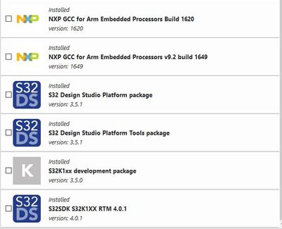

aurrutia
Hi everyone,
I have found the same issue, I am working with the family S32K1 (S32K144). I have just downloaded S32 Design Studio for S32 Platform
Version: 3.5.
I follow the link: HOWTO: Create a Blinking LED example project using S32K1xx RTD without AUTOSAR and I can see that I have all the necesary firmware installed for the correct working of the IDE.
  • S32K1 RTD AUTOSAR 4.4
  • S32K1xxx development packages
when I take an example from the SDK (this project is correctly generated and takes into account the folder platform/devices) and worked as expected when I built it. But when I create a new project (S32DS Application Project), I can't attach the SDK in the configuration of the proyect and the final result when I finish the process is that the project doesn't have this folder generated.
Any idea that what could be happening in my IDE?.

aurrutia
Hi Laura,
I think that I have the response for our problems. In my case the SDK 4.0 RTM for my microcontroler needed the gcc 6.3 for the correct generation of the code. So in the rest of the cases gcc 9.x AND 10.X doesn't work in my case.
Aitor

l_sanz
Hi @VaneB and @mikedoidge
I'm using a S32K118 MCU for development. I have installed everything related to my MCU. There was no option to install S32K1 RTD AUTOSAR 4.4.
When creating the project if I select the the GCC9.2 then in the SDK selection menu I don't have PlatformSDK_S32K1_2022_02_S32K118_M4F like specified in step 7.
Everything else I do like the tutorial says. Could it be that I need to download and install something more?
Thank you very much for the help!
