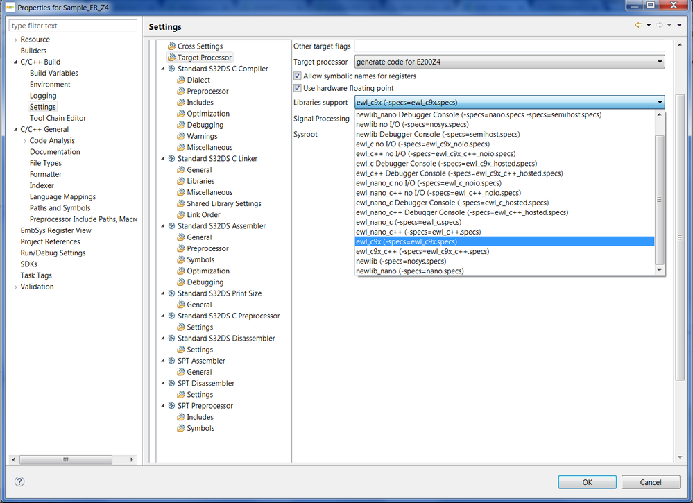

So I am new to S32DS and have a problem understanding a few parameters regarding the EWL and NewLib libraries for the project.
I have a general idea as to what the libraries are from  S32DS EWL and newlib standard clarification
Q1. On creating a new S32R274 Project, under project properties, there following Library supports. What are all these libraries? What id the difference between ewl_c no I/O, ewl_c Debugger console and ewl_c9x? How can I know Where can I get information on all the different specs?

the I/O and no I/O means that with I/O you can use printf functionality via Debug probe.
The specs option shows which gcc args set was used for library build. You can find these files in S32DS Instalation - [YOUR_INSTALL_PATH]\S32DS_Power_v2017.R1\S32DS\e200_ewl2\lib\
for newlib are .specs located here:
[YOUR_INSTALL_PATH]\S32DS_Power_v2017.R1\Cross_Tools\powerpc-eabivle-4_9\powerpc-eabivle\newlib\lib\
Hope it helps.
