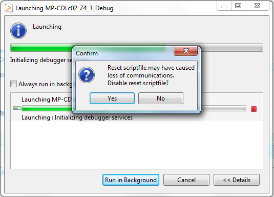

I'm flashing an MPC5777M on on own board design for the first time and seeing the pop up window below each time.

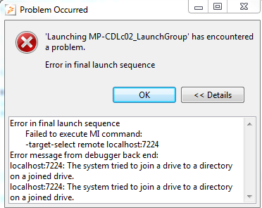

Is this a sign that I have something wrong on the board or another issue? I'm seeing this after entering debug from S32 Design Studio. I'm using a PE Multilink Universal to interface. Once I cycle power it SEEMS to finish flashing, but then I get another error shown below. I'm not sure if the issues are related or separate.

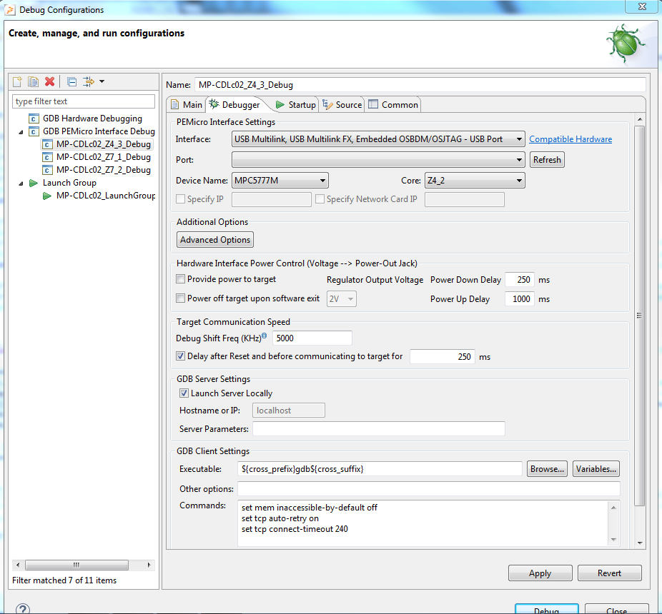

Could you possibly try to add a delay after reset into your main core debug configuration:

I am actually trying to enter debug from within S32DS. However, I shut those processes down, restarted S32DS and tried again. I even added a 250 ms delay into the debug settings just as Stanislav suggested. I see the same error. Below is what my debug settings look like.

After taking the screen shot of the debug settings, I noticed that the port was not showing up. This persisted even if I clicked Refresh. I saw the driver load when I plugged in the USB Multilink and confirmed it was recognized in my device manager as shown below. Maybe this could be part of the problem?

BTW, I am correctly seeing the port now in the debug settings.

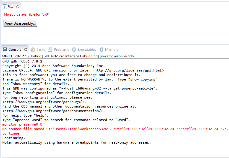

I have updated drivers for PE Micro. Results below.
I have also added an external power supply to the 1.3V bus to rule out power issues.
After adding the external power I seem to be getting the reset escalation error less often, but I seem to be getting several different other errors seemingly random. I've included screen shots of the errors I'm getting. Sometimes they occur and sometimes they don't. I am pretty sure I have not been able to actually get my program to run at all. I thought I was starting off simple by just setting up a single pad, T15, to toggle. The associated SIUL register never changes from default even though I have the line:
SIUL2_MSCR_IO_288 = 0x12380000;/* Set PT15 to GPIO */
I'd appreciate any help in getting pointed in the right direction.
