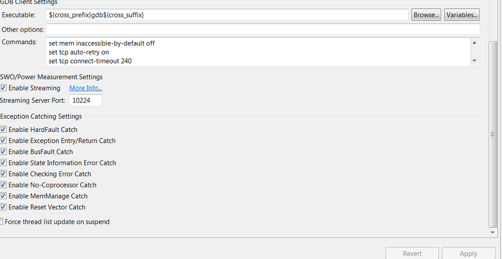

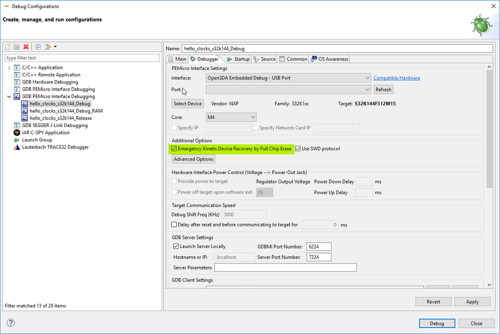

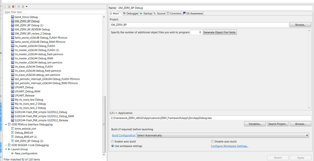

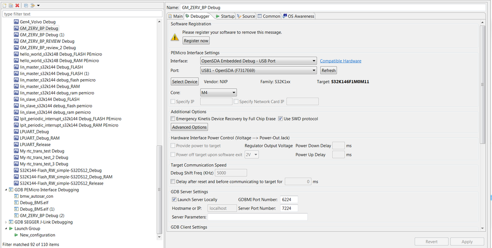

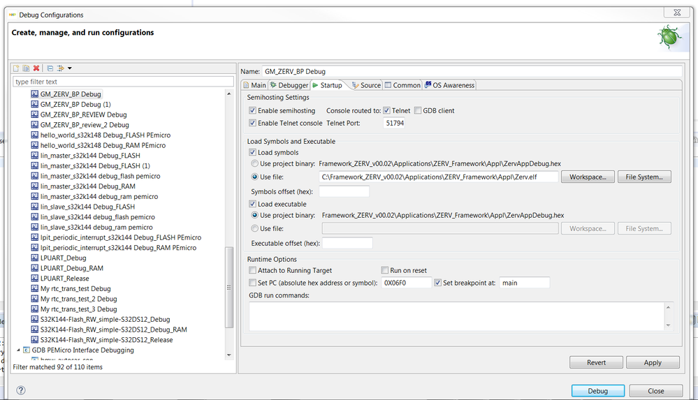

debugger_client_setting.PNGdebug.PNGmain.PNGdebug_config.PNGHi Jiri:

jiri_kral
did you tried emergency kinetis device recovery?
Also your PE Micro plugin is old. try to update it -
https://community.nxp.com/docs/DOC-342273
Hope it helps.
Jiri
3,771 Views
hajianik
Senior Contributor I
yes I did.
