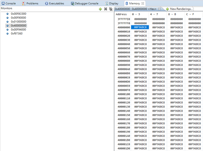

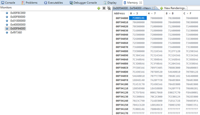

When I finish debugging and before executing, I can see that both RAM and Flash memory contain data, as shown in the figure.
0x00F90000:
0x00F94000:
0x40000000:
The data in RAM gets cleared when I press the reset button, but the data in Flash remains. However, the program is not executing either.

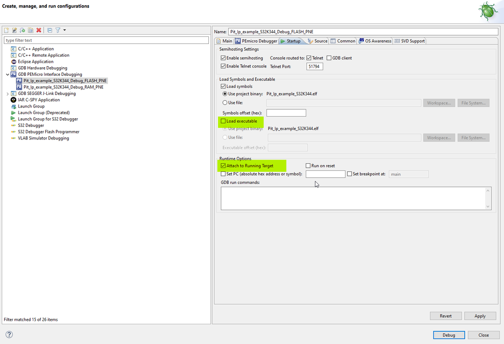

I tested attached project (I need to modify it slightly because I have only EVB). And there is no issue on my side. There was some strange settings in debug configurations which I fixed. The modified project is in attachment. After reset or power cycle - the board LED stats blinking.
If you have Mother Board - just remove DEVIT define in main.c:
3,699 Views

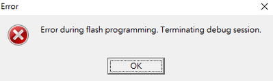

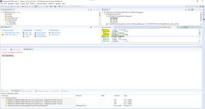

After commenting out the define DEVKIT, when I was debugging, I was asked to power cycle.
When I turned off and restarted the power, it threw this warning and error.

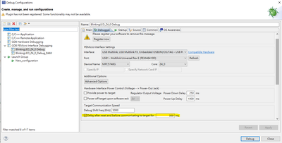

According to the method shown in the diagram.
"Turn the power off, press and hold the reset button, turn the power on. Now release the reset button and press "Connect" within 300ms."
I adjusted the debug configuration by setting a 300ms delay after reset.
The debug configuration was successful.
However, after executing it and then turning off and restarting the power, the LED stopped emitting light.

I observed that it continuously looped at the addresses 00f8c3e4, 00f8c3e8, 00f8c3ec, 00f8c3ee, and 00f8c3f0.

in my attached project - there is no code around the address 0xF8C3E4.  The RCHW starts on 0xF90000. There is probably some un-erased old code which starts instead the blinking LED. Some Boot Loader?
