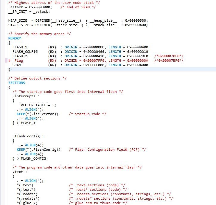

     Hello!
     I want to put a constant array into a specified flash memory (address is 0x00007FF0)in S32 Design Studio for ARM.However,"const  char flag[10]@0x00007FF0" doesn't work.

you need to add custom section into linker file:
/* Specify the memory areas */
MEMORY
/* Flash */
m_interrupts (RX) : ORIGIN = 0x00000000, LENGTH = 0x00000400
m_flash_config (RX) : ORIGIN = 0x00000400, LENGTH = 0x00000010
m_text (RX) : ORIGIN = 0x00000410, LENGTH = 0x00007BE0
m_mydata (RX) : ORIGIN = 0x00007FF0, LENGTH = 0x000000FF
/* SRAM_L */
m_data (RW) : ORIGIN = 0x1FFF8000, LENGTH = 0x00008000
/* SRAM_U */
m_data_2 (RW) : ORIGIN = 0x20000000, LENGTH = 0x00007000
/* Define output sections */
SECTIONS
.mydata :
   KEEP(*(.mydata))
} > m_mydata
and define variable by using __attribute__ like this:
__attribute__ ((section(".mydata"))) const char flag[] = {"ABCDEFGHIJ"};

tanmingming
Thank you very much for your help.
 It's useful to add the "KEEP".I have solved the problem. :smileyhappy:
