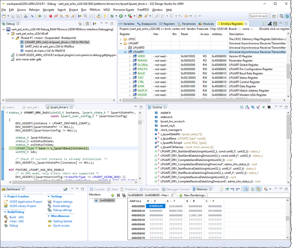

I'm a student who is studying with the S32K148EVB board.
I'm debugging lpuart example provided by S32DS for understanding uart programming.
I failed to open the memory value through the 'OpenSDA' of the EVB board and PEmicro Debugger on S32DS 2018.R1.
So my question is, is it impossible to read memory through OpenSDA and PEmicro Debugger?
I powered and debug the board with a USB port through the computer with 'S32DS 2018.R1' and 'S32K SDK 0.8.6 EAR'.
Is there any solution to watch the memory value of the board??
thanks.

Hi HeeSu,
Please read View peripheral registers and Viewing memory chapters of arm_pdf_reference.pdf(C:\NXP\S32DS_ARM_v2018.R1\S32DS\help\pdf)
By the way, S32 Design Studio for ARM Version 2018.R1 is very old, it is recommended to use S32DS v3.4.3 +S32K1 SDK RTM 4.0.3.
