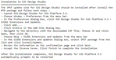

It seems that there is already a newer version of this IPCF package:
Take the file IPCF_1.1.0_D2012_updatesite.zip:
It has more complete S32 Design Studio integration and uses the latest version of S32DS 3.3
From S32_IPCF_1_1_0_D2012_ReleaseNotes.txt:

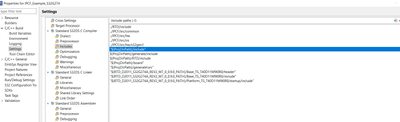

Thanks for the reply. I tried the mentioned way and now I can see the IPCF project in the example. But there is a problem when I build the IPCF sample project (IPCF_Example_S32G274).
I get quite some errors (Image attached to this post). Could it be due to missing SDK for S32G (Product Software Development Kit for Cortex-M)? Any help would be appreciable.

jiri_kral
it looks that you don't have properly set Include path for IPCF header files:

Somasundaram_Vadivelu
Thanks for the response. It seems I have all the required includes.
