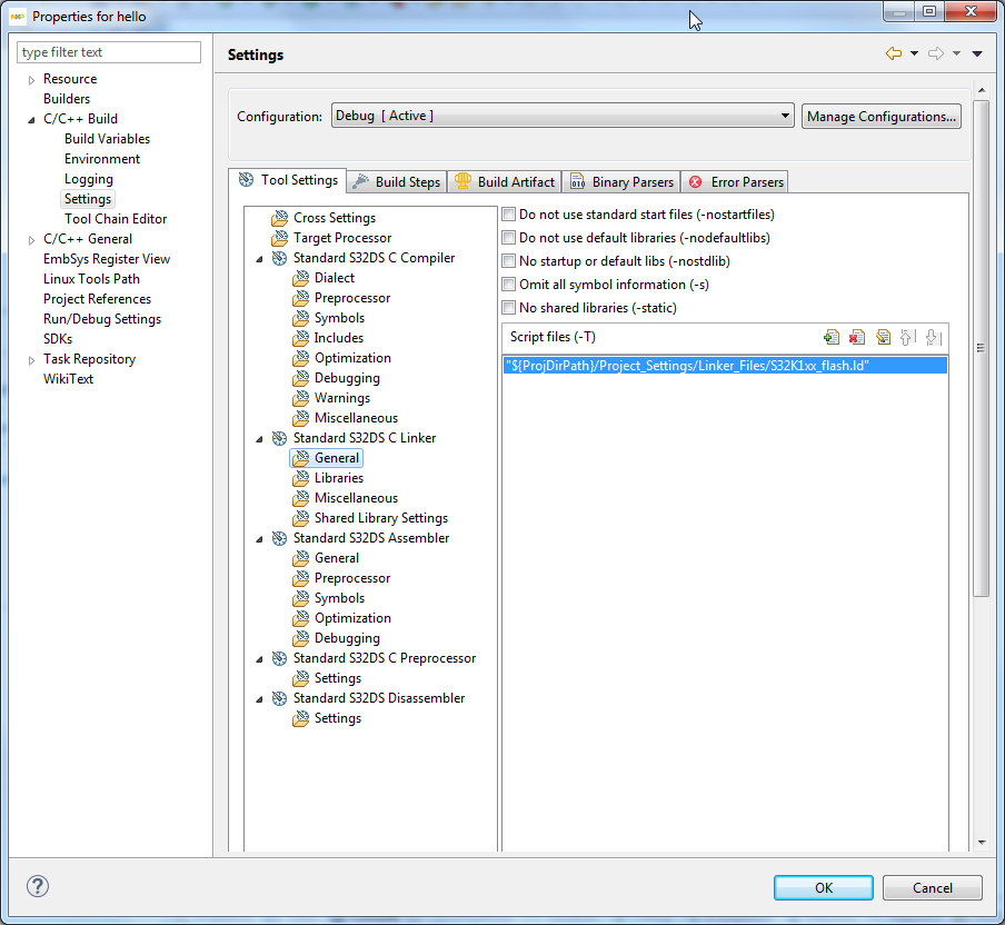

markdresser
Thanks for your assistance!
It appears that the line is set in the Linker tool settings but it is not finding it's way into the .args file?  I'm not aware of having done anything to change it from the original default.  Sorry, I'm new to gcc so there is a lot of magic going on that I don't understand.

jiri_kral
Hi Mark,
you have empty file specification after linker  -T option. There should be path to linker file.

Please check the project properties - right click on projet name -> Properties and in liker settings check -T option parameters:
Hope it helps.
