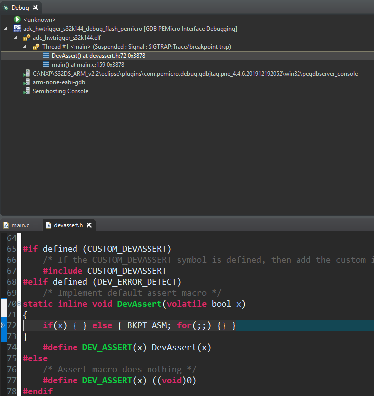

The debugger unexpectedly stops at the following when I change ADC channel from 11U to any other channel (I've tried 5 or 6).
I'm using the adc_hwtrigger_s32k144 example.  It was originally working at channel 12 out of the box and I made some changes to the ADC and moved to channel 11 and everything was working great.  I was printing the ADC output to the console correctly by changing the print() calls to printf().  When I changed from channel 11 to channel 10, I got the following screen:
Clicking resume doesn't move past it, I'm stuck in this for loop.  Never prints ADC to console.  I changed printf() back to print() but no luck.  Only thing that gets it working again is changing the channel back to 11.
I played with the ADC settings in processor expert but reverted back and no change.  Very strange.

seems it is stopping at below line in main.c
DEV_ASSERT(adConv0_ChnConfig0.channel == ADC_CHN);
So do you have channel selected in ADC component same as ADC_CHN defined in main.c?

I started fresh with the example and generated PE code as soon as the example loaded.  The only change I made was to the line in main.c that defined the ADC_CHN.  I did not think I needed to generate code again.  I did make changes and generate code after the problem started happening though so I don't believe that is the issue.
#define ADC_CHN         12U
#####UPDATE######
I figured out the problem after thinking about what you said and figuring out what the DevAssert function was doing.  The PE has assigned a channel to the ADC and I'm changing it in the code but DevAssert() is checking that it's still the same as what PE assigned it.  Since I changed it, it hangs.
