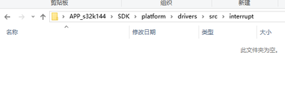

I want to export all the files of the project, but I cannot find some files in the final exported project folder .
for example ,I can find "interrupt_manager. c" in the development environment directory "\ SDK \ platform \ drivers \ src \ interrupt",but it's empty in the exported project folder,and when I search in the workspace project folder,it's empty too and the same to "S32K144_64_flash.ld" .how can I make all the files in the exported project folder.

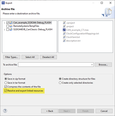

Please make sure that when exporting, all the files are included and selected for the destination folder/zip:

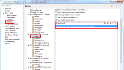

As for the linker file, when creating a new project using project wizard there are typically 2 linker script files (S32K1xx_flash.ld and S32K1xx_ram.ld) these files are local copies for the project so any modification in the file should influence just this project.
If you need to change the .ld file, please go to project properties -> C/C++ Build -> Settings -> "Standard S32DS Linker"/General and adjust the "Script files" path:

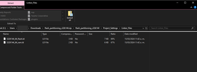

I can see the Linker_Files folder with both files when exporting the project, even when I use "File > New > S32DS Project from Example". Could you confirm you are building and correctly export the project? You could also try selecting the "Resolve and export linked resources."
