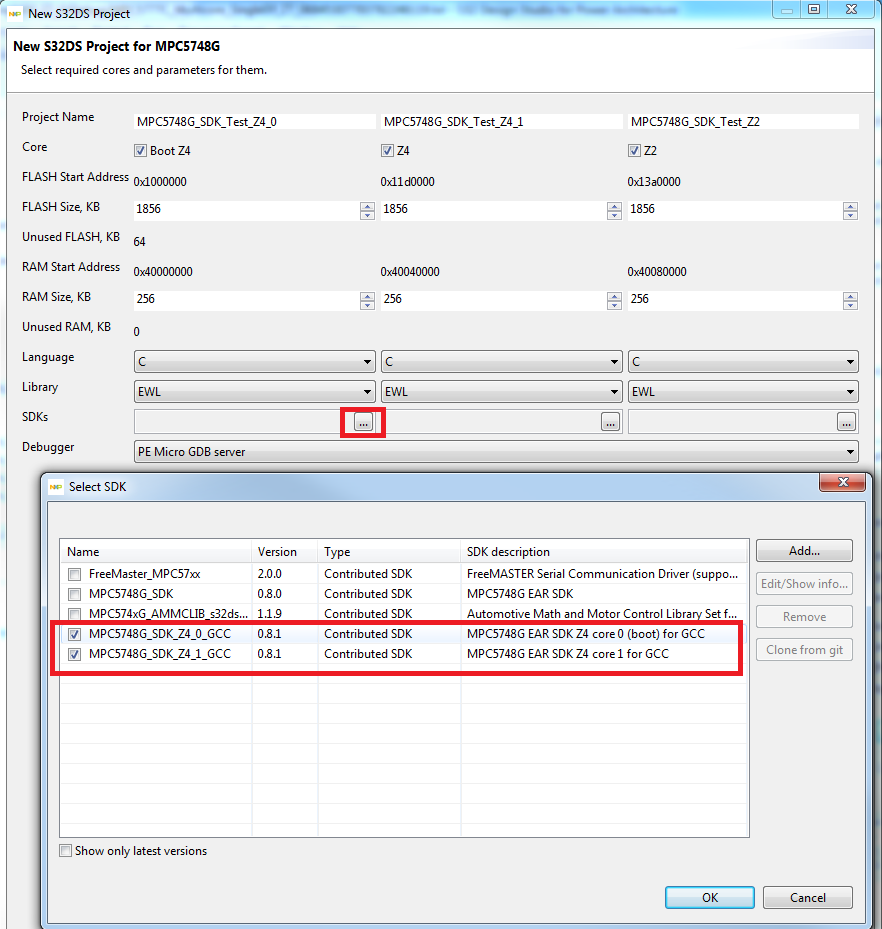

S32 SDK EAR 0.8.1 supporting MPC5748G & MPC5748C.
The new project wizard now offers the new version of S32 SDK:

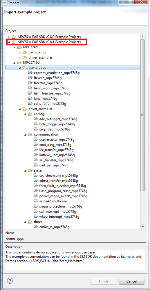

"New S32 Project from Example" offers additional demos and examples.

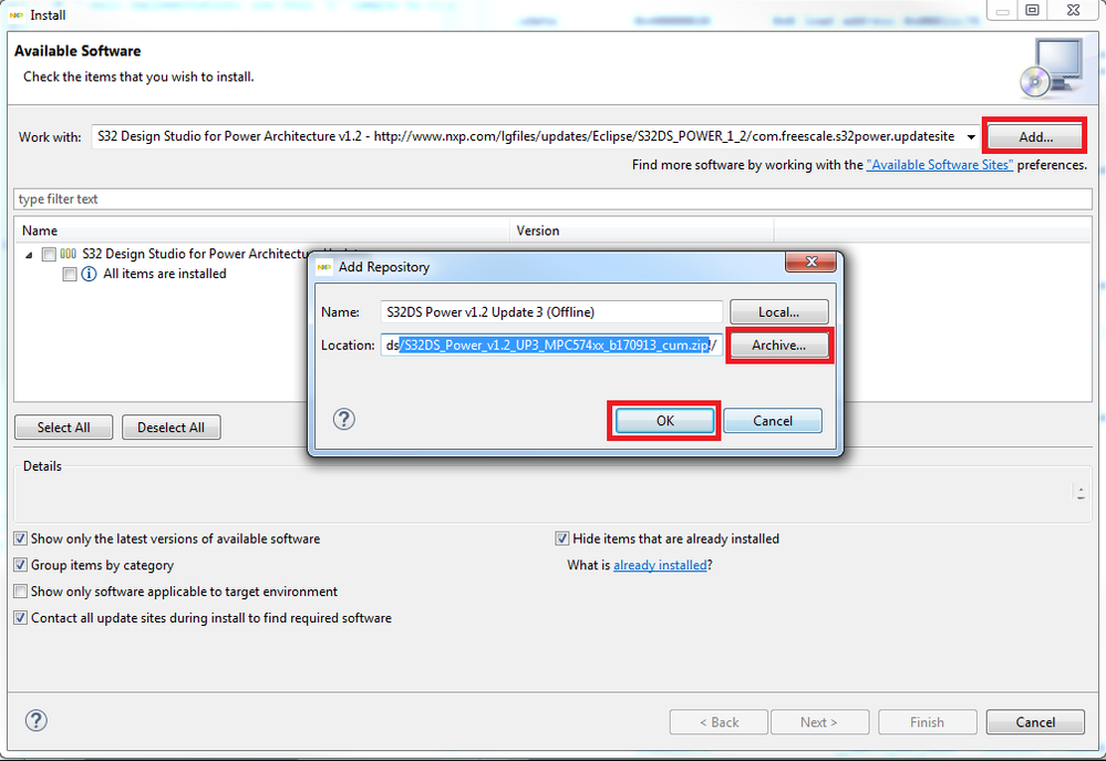

    • Start S32DS and go to "Help" -> "Install New Software..."

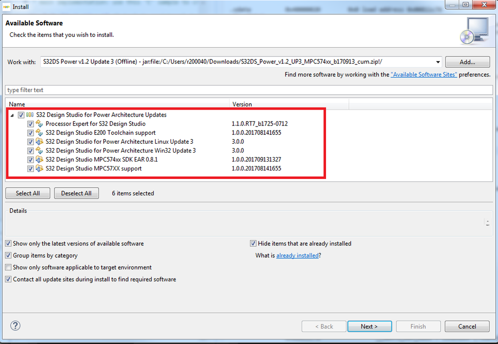

    • Add a new "Archive" repository and browse to select the downloaded Update 3 archive file
    • Select all available items and click "Next" button.
