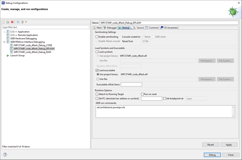

Now if you build the project you can see the data that belong to dflash and code flash in the .map or srec file. If you debug the project using the default debug configuration data flash (DFLASH) memory is not programmed.

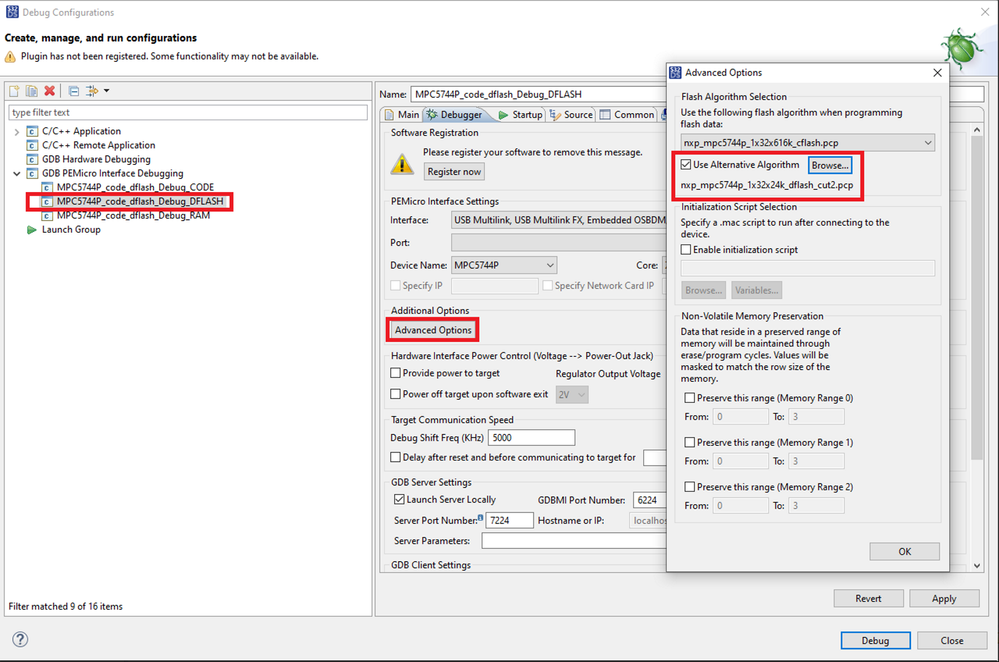

To program DFLASH you should create another debug configuration simply by duplicating the existing one and changing the programming algorithm to dflash one: nxp_mpc5744p_1x32x20k_dflash.pcp.
There are many flash programming algorithms available in PEMICRO eclipse plugin folder typically located here (version of plugin may vary):
"C:\NXP\S32DS_Power_v2.1\eclipse\plugins\com.pemicro.debug.gdbjtag.ppc_2.0.2.202005132054\win32\gdi\P&E\"
S32DS: Duplicate  Debug ConfigurationS32DS: Duplicate Debug ConfigurationS32DS: Load parametersS32DS: Load parametersS32DS: Choose alternative programming algorithmS32DS: Choose alternative programming algorithmNow the new debug configuration (MPC5744P_code_dflash_Debug_DFLASH) is able to program data flash memory.

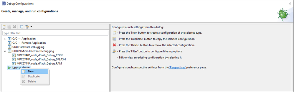

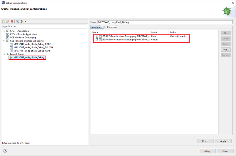

The final step is to create a launch group configuration and associate it with all the programming/debugging configurations that should be executed once debug is started.

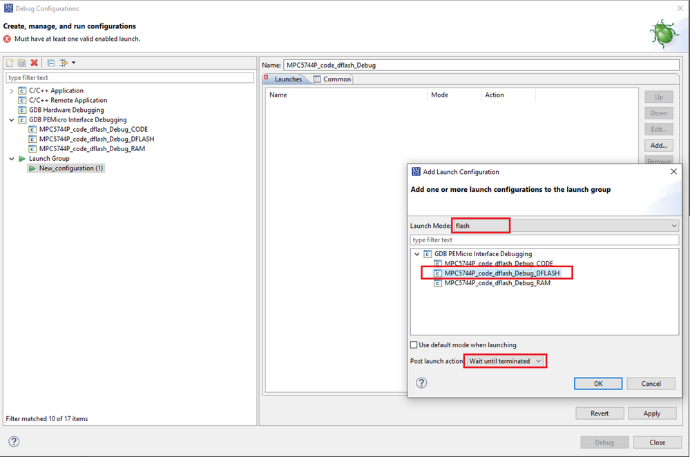

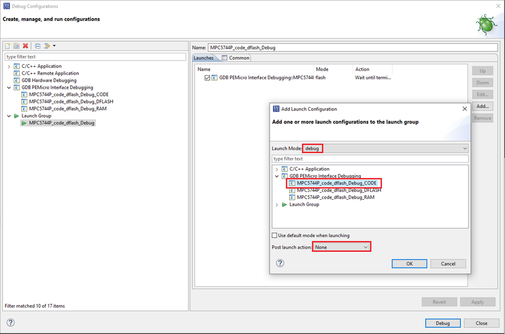

Add the debug configuration used just for programming purpose as flash type and code debug configuration as debug type. In order to avoid interference between programming of various memories select post launch action -> "Wait until terminated"

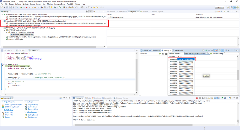

S32DS_Debug_Data_Flash_Launch2.pngS32DS_Debug_Data_Flash_Launch3.pngS32DS_Debug_Data_Flash_Launch4.pngFinally as soon as the debug session is established by launching the launch group created above - all the memories are programmed and you can debug the code.
There is an information about executed flash configurations in the debug context view. Since the programming has alredy finished the thread is terminated and could be cleared by double cross icon.
