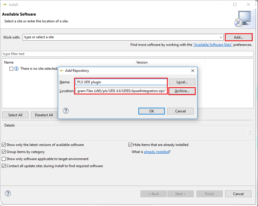

1. go to menu "Help" -> "Install New Software" and  click on "Add..." button and search PLS UDE installation folder for the archive file named "UDEEclipse4Integration.zip"

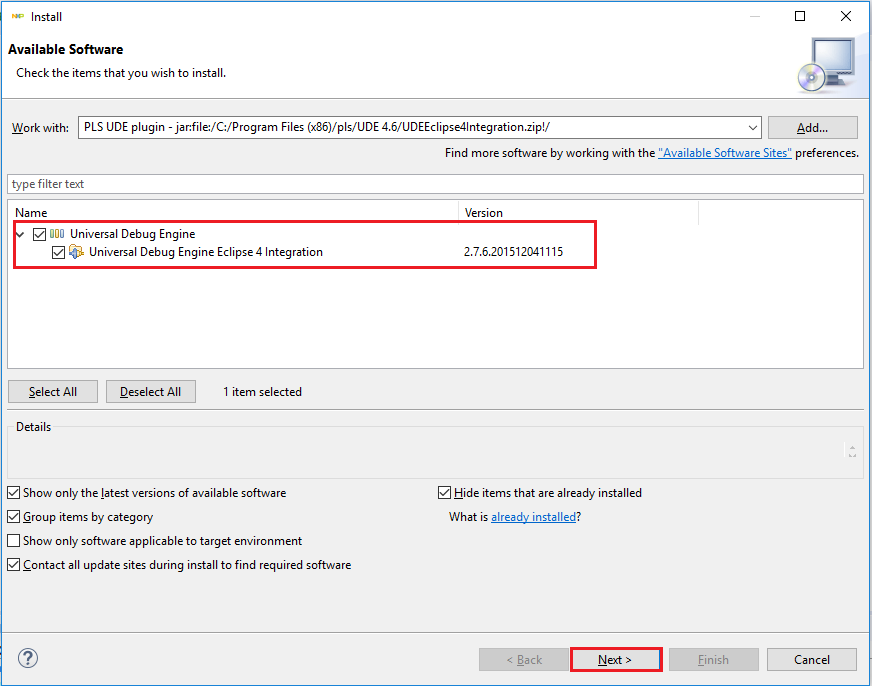

2. select the Universal Debug Engine component and click "Next"
3. Finally you proceed to the installation. You will be asked to confirm installation of unsigned content. The UDE plugin requires restart after the installation.

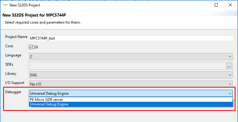

You should be able to create a new S32DS project via S32DS new project wizard where PLS UDE Debugger support is now available.

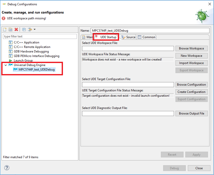

The UDE plugin enables a new group of UDE eclipse debug configurations to manage (create, delete, adjust)
The UDE debug configuration created with a new project requires some changes before you can proceed to debugging.
1. Enter a new UDE workspace name under "<Project>\.ude" folder by clicking on "New Workspace" button

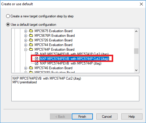

2. Create a new UDE Target configuration file.
  • click on "Create Configuration" button and select "Use a default target configuration" and your target MCU. (in this example MPC5744P).

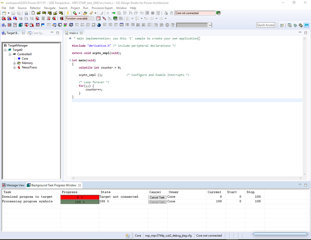

Running the debugger opens UDE specific debug eclipse view where you can benefit from many advanced debugging features including tracing, scripting...
