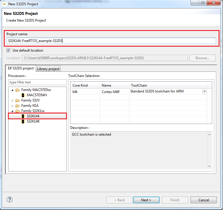

1) Create new project. Choose S32K144 microcontroller. Click Next.

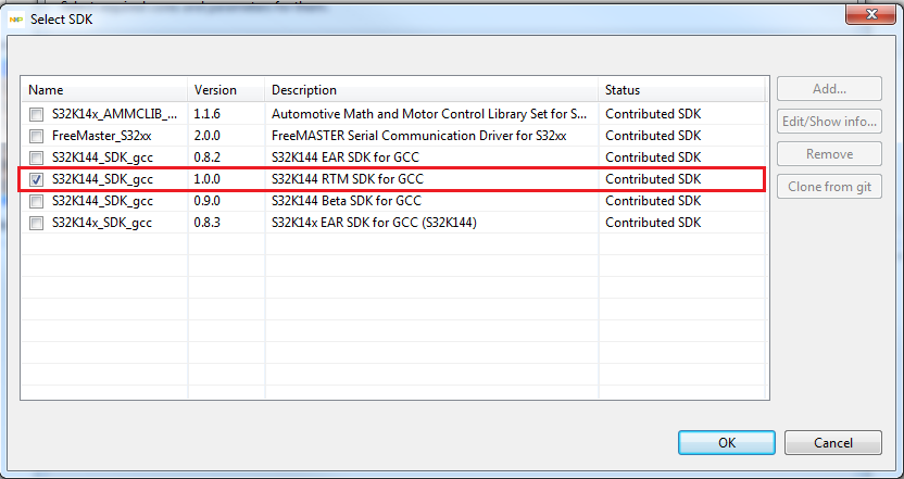

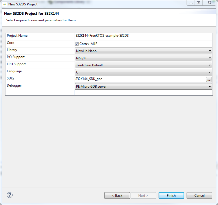

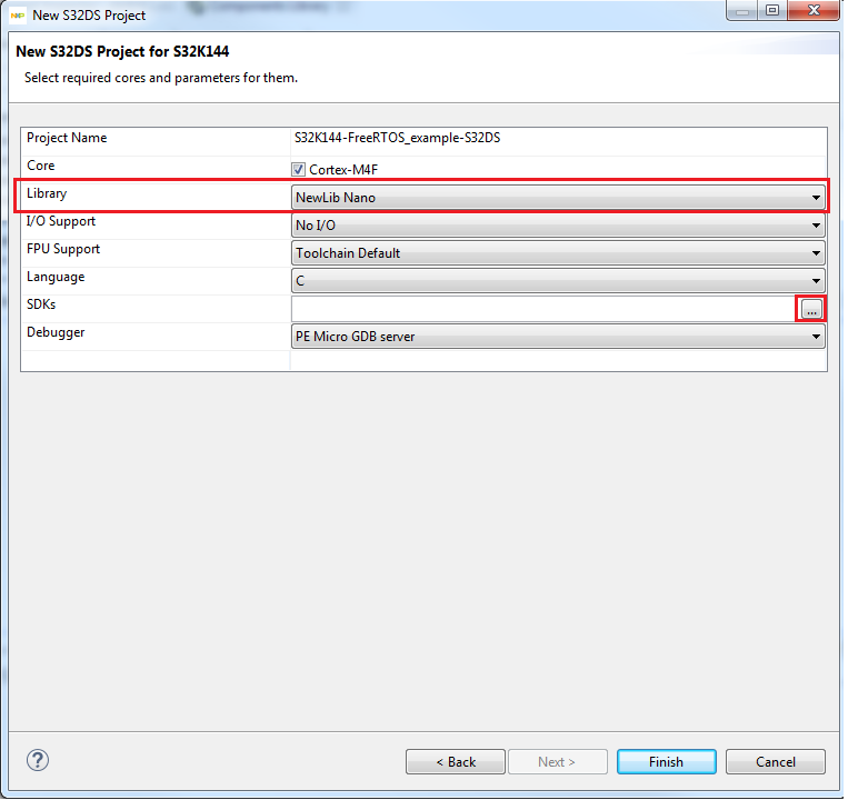

2) Choose NewLib Nano Library, and choose S32K144_SDK_gcc RTM 1.0.0. Click Finish.

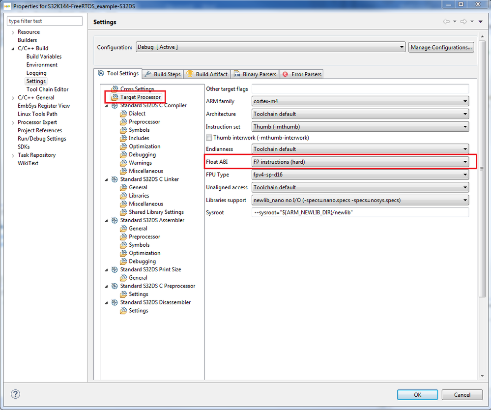

3) Open project properties and click Target Processor tab. For Float ABI, choose FP instructions (hard).

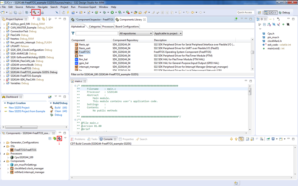

4) Open Component Library, right click FreeRTOS component and add this component to project.
5) Last, Generate Processor Expert Code and compile project.
Now, you can use FreeRTOS component in your project.
