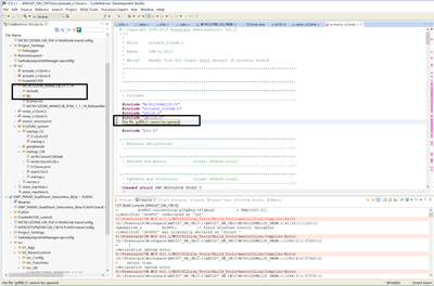

I imported the SW project to code warrior 11, it seems all  the AMMC lib not included in the sw package, so i copied the AMMCLIB_v1.1.14 to the project and updated the include path in the properties.
however i got many errors after build .Interesting thing is i already include the lib, but the IDE hint is :"the file'gdflib.h' cannot be opened".
is it caused by the code warrior version? if yes can you post the link to download?i only found the V11 and also in the previous version i found V10 for eTPU .

you are right, the sw project does not contain the AMMCLib inside the project.
The error means that AMMCLib was not included properly.

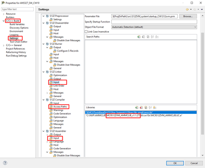

The AMMCLib in the source project is linked from the default folder C:\\NXP\AMMCLIB\MC9S12ZVM_AMMCLIB_v1.1.xx
where xx may vary according to your AMMCLib installation.
The latest AMMCLib (currently 1.1.33; you may download also previous versions) may be downloaded from nxp.com/AMMCLib
The path to the library must be updated on three places in project settings (in Linker, Compiler, Assembler sections). See highlighted positions on picture:
just double-click on the path and rewrite the number 27 to version that you installed into default location.
The API should be fully compatible across AMMCLib versions. So, you should be able to use almost any version.
Hint: I would like to recommend also clean project before building everytime when you import any project (there might be files in FLASH folder that cause problem with paths). Optionaly you may delete the FLASH folder and Refresh (F5) the project.
