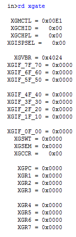

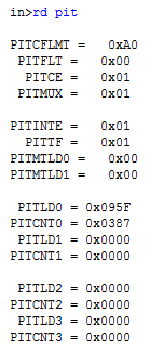

Using a debugger to read from the registers I can confirm that:
  • The timer is counting properly and setting flag PITTF_PTF0 when it times out.
  • The RQST flag and priority have been set for PIT0 interrupt.
  • The XGMCTL register is set correctly (XGE, XGFRZ, XGIE).

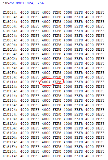

  • The value at the Xgate vector address for PIT0 points to the flash location of the ISR (0xE18004 in map file and 0x4004 at vector address)
What am I missing here?

If it helps, here are the key registers at runtime:
As far as I can tell, the interrupt is firing, the Xgate is on and should be accepting interrupts, the Xgate vector register is pointing to the vector address, and the vector corresponding to PIT0 is pointing to the handler.
