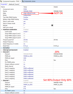

Dear team,

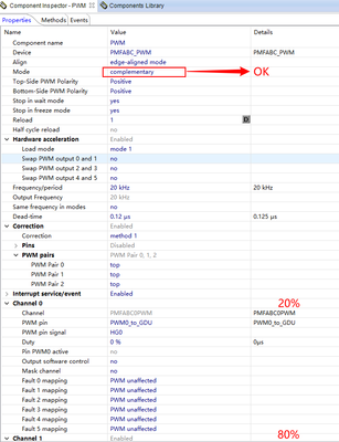

    We need to  drive a DC-motor by H-bridge,so we used 4 independent channels(HG0,LG0,HG1,LG1) to output PWM(Used GDU module,20kHz frequency) in S12ZVML MCU.
   The questions as follow:

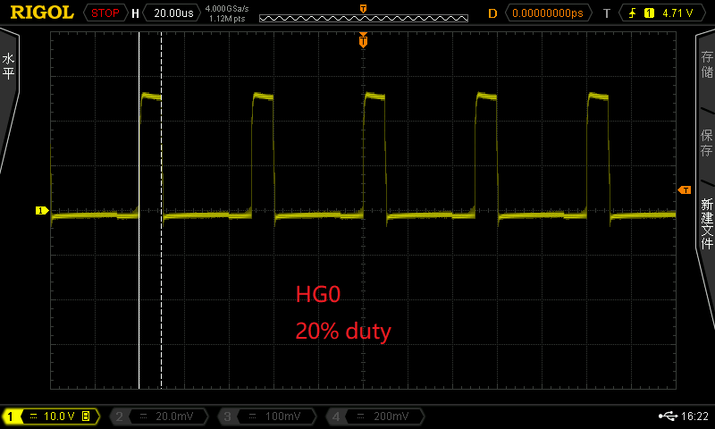

    When we configured 4 channels PWM as independent mode,we set 20% duty at HG0,80% duty at LG0.HG0 output is ok,but LG0 output only is 60% duty. We watched PWM register is correct,but LG0 output duty is not correct(only 60%).
    But when we switch 4 channels PWM as complementary mode,all output are ok(HG0 20%,LG0 80%).
    We offer some wave and pictures,could you help us to solve this problems?

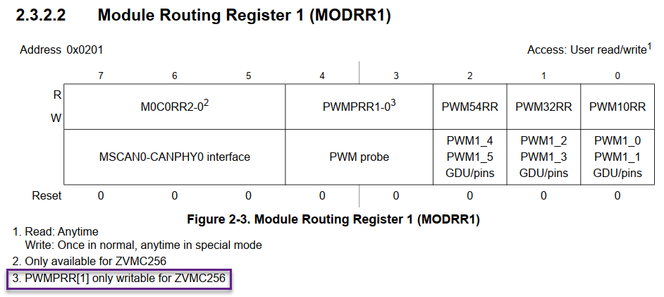

Hi @gary_lu1,

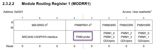

The GDU module does not allow the LGx and HGx pins to be active (HIGH) at the same time.
If the independent PWMs are incorrectly configured, the GDU will ground one of the signals in the pair.

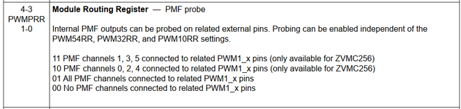

PWMPRR[1] is available for ZVMC256 only
But PWMPRR[0] is available on all the S12ZVM parts.
1. Probe function
PWMPRR = 0b01 All PMF channels connected to related PWM1_x pins
2. PWM directly router to GPIOs.

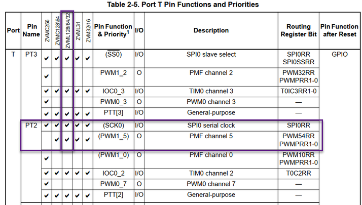

The pins can be directly routed to PWM1_n pins (PWMxxRR = 0b111), which would disable signals to the GDU.
There are PWM1_n pins on ZVML128
PT0, PT1, PT2, PP0, PP1, PP2
PT2:

We have found the root cause,when PWMs were configured independent,we set
Set(HG0,20%duty),Set(LG0,80%duty)At the same time ,the HG0 and LG0 will start calculate duty in one time base,and the HG0 and LG0 be actived,so HG0 duty = (80% duty -20% duty(HG0)),beacuse all of them be configured with postive.
We have changed ways to realise out function,thank you again!

Hi @gary_lu1,
Can you probe the PWM signals at the PWM1_x pins, so that you can see the Pulse-Width Modulator signals before it goes to the GDU.
Can you show both waveforms of the PWMs (HGx, LGx) in a single image?

We can not probe the PWM signals beacuse  only avalible for ZVMC256,but we used ZVML128,no PWM_1 pins be found.
I showed the waveforms of PWMs in one image.(yellow:HG0,purple:LG0).
Furthermore,we tried to change the PWM polarity(Top-Side:postive,Bottom-side:negative),and the waveforms are ok.But we think it not a finals ways for above problems.
Could you give us some advice?
