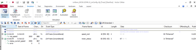

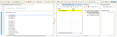

1. After flashing the code and running the code in debugg mode I'm able to control the speed of the motor using CANoe. PFA
2) But, after flashing the code, removing the debugger and resetting the MCU, I'm not able to control the speed of the motor using CANoe. PFA

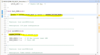

3) I found a nxp post regarding the same issue. I'm attaching the link here Link to Post . Here you suggested to check for the write only once register.

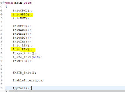

4) In code I found out that the MODRR0_SCI1RR register is written twice first in initGPIO() and then in Init_PIM(). PFA
itsnewforme_3-1663929111291.pngitsnewforme_3-1663929111291.pngitsnewforme_4-1663929189406.pngitsnewforme_4-1663929189406.png
5) But, If I comment any one of the function Init_PIM() or InitGPIO(). I'm still facing the same issue.

Hello @itsnewforme,
Both writes are identical, so the second write can be ignored.
