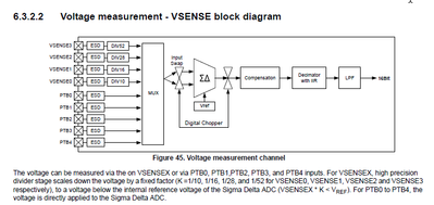

I want to measure a temperature by a voltage divider and the VSENSE0 input but I´m not sure about the supply voltage of the voltage divider.
My questions are:
- Is the vsense0 input an "absolute" input?
- Is the vsens0 an "relative" input and what is the reference voltage?

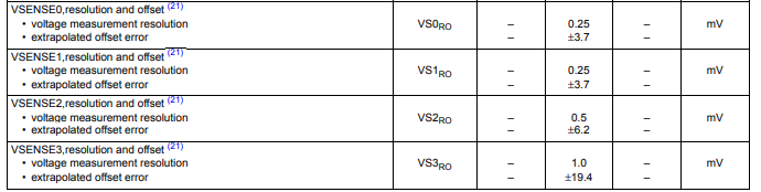

I just found the following picture in the manual (page ), but no Vref value.
1,932 Views
TomasVaverka
There is no need to know the Vref value of VSENSE.
The measured selected (based on VSSEL and VSEx bits of the GPIO_VSENSE register) voltage can be calculated as follows:
1. VSENSEx: V = ACQ_VOLT[15:0] x VSxRO
2. PTBx: V = ACQ_VOLT[15:0] x PTB0-4VRES
Tomas

Dear Tomas,

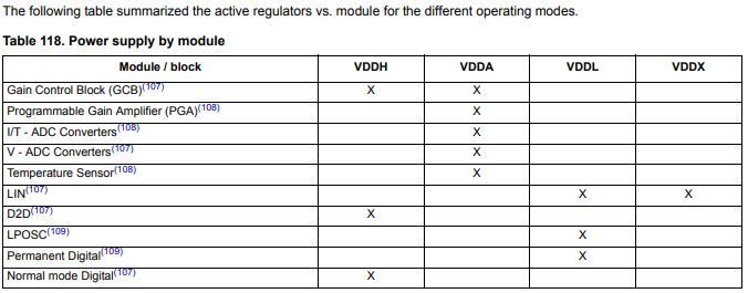

thanks for the reply. I know for the PTBX inputs I don´t need to know the supply voltage, because the input voltage is supplied/generated by vdda (relative input). The questions is, what suppy voltage could I use for the Vsense0 input with a input range of 0 to 10Volts. Do you mean it doesnot matter because its an absolut input?
regards
1,928 Views
TomasVaverka
Tomas
