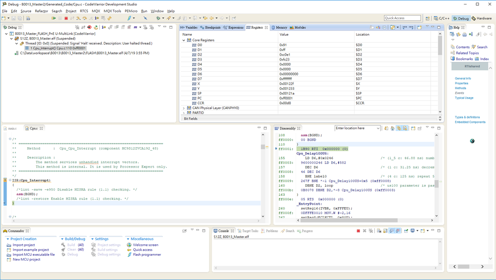

We are using S12ZVCA & Codewarrior v11.0.1. The system generated unhandled interrupt sometimes.
How to find out the unhandled interrupt?

At first, I would like to recommend you to look at the interrupt catcher example code for the S12ZVL,
however, you can use it for the S12ZVC. See link below:
https://community.nxp.com/docs/DOC-330312
Using the interrupt table should be able to process all unexpected interrupts.
Also, Table 1-13. Interrupt Vector Location in RM rev 2.0 can be useful.
