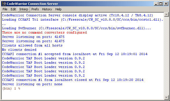

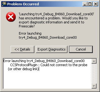

Sadly, after installing Code Warrior (SC 10.8) and following the instructions in the CW for StarCore getting started guide, we are failing to get a USB TAP connection working with our board (Win XP host).
We need to run some performance tests on the SC3900 cores but are stumped for now.
Any tips for getting the board up and running would be much appreciated.
The images below may help in a diagnosis.

from CCS I can find the B4860QDS board via USB thus
(bin) 1 % findcc cwtaps
FSL031A32 (00:04:9f:03:1a:32): Embedded CodeWarrior TAP (0)
Power Architecture JTAG/COP Probe Tip
Boot Loader v0.9.2
Operating System v1.0.1
(bin) 2 %

lunminliang
I have done the update. It looked to work OK.
Now I am getting
Error launching TryUpdated_Debug_B4860_Download_core00
CCSProtocolPlugin : CCS: Core not supported
Any ideas what is wrong now ?
Bill.

CCS shows log below.The connection #1 lines are from an attempt to connect the CodeWarrior debugger.
Does the "no command converters" bit matter (it is shown in red) ?
CodeWarrior Connection Server console display active (Tcl8.4.12 / Tk8.4.12)
Loading CCSAPI Tcl interface (C:/Freescale/CW_SC_v10.8.0/SC/ccs/bin/ccstcl.dll)...
Loading Svfburner (C:/Freescale/CW_SC_v10.8.0/SC/ccs/bin/svfburner.dll)...
There are no command converters configured
Server listening on port: 41475
Clients allowed from all hosts
No clients denied
CCSAPI connection #1 accepted from localhost at Tue Sep 23 08:55:19 2014
CCSAPI connection #1 from localhost closed at Tue Sep 23 08:55:32 2014
(bin) 1 % findcc cwtaps -verbose
{amphisbaena} FSL031A32 (00:04:9f:03:1a:32:1087):
  Main Board          = Embedded CodeWarrior TAP (0)   {0x0 0x0}
  Probe Tip           = Power Architecture JTAG/COP    {0x8}
  Firmware            = Boot Loader                    {1.0.1}
  Firmware            = Operating System               {1.0.2}
8087&PID_0024 5&1257EA4F&0&1
no devices found

8,584 Views
catalindemergia
It could be the JTAG clock speed (in CodeWarrior go to your Debug Configuration and Edit Connection, there is a
JTAG clock speed edit box). By putting a bigger value there I managed to reproduce the "core not supported" message
in my setup. So, set the value that you have to something smaller. In my setup it works with 10230 kHz.
Catalin
8,575 Views
billchadwick
I have
and
8,575 Views
catalindemergia
can you check one more thing - enter the commands like bellow (in ccs console) and
see if you have the same output.
(bin) 51 % dele a
(bin) 52 % config cc cwtap
(bin) 53 % show cc
0: CodeWarrior TAP (cwtap) CC software ver. {0.0}
(bin) 54 %
(bin) 54 % ::ccs::config_server 0 1000
(bin) 55 % ::ccs::config_chain t4amp
(bin) 56 % ::ccs::all_run_mode
t4amp: Debug Mode
e6500_thread0: Debug Mode
e6500_thread1: Debug Mode
sc3900: Debug Mode
sc3900: Debug Mode
sc3900: Debug Mode
sc3900: Debug Mode
sc3900: Debug Mode
sc3900: Debug Mode
Catalin
8,575 Views
billchadwick
I get
(bin) 7 % dele a
(bin) 8 % config cc cwtap
(bin) 9 % show cc
(bin) 10 % ::ccs::config_server 0 1000
(bin) 11 % ::ccs::config_chain t4amp
T4AMP SoC: Core not responding
(bin) 12 %
8,575 Views
addiyi
Could you please check if the SW settings are the same as in link provided by Catalin? If your board have other SW settings please use the one from info center and try again, If the Core not responding issue is still present, it is very possible ecwtap is defect.
Adrian
8,575 Views

With my second board I look to be getting a bit further
No clients denied
FSL031A4A (00:04:9f:03:1a:4a:1087):
Firmware = Boot Loader {0.9.2}
Firmware = Operating System {1.0.1}
no devices found
(bin) 2 %
(bin) 3 % updatecwtap FSL031A4A
FSL031A4A is running OS version 1.0.1
Update contains OS version 1.0.2
WARNING: UPDATING FLASH - DO NOT INTERRUPT!
Sending code to CodeWarrior TAP.........done
Running package script
Erasing kernel partition...
Flashing kernel partition...
Erasing root1 partition...
Flashing root1 partition...
Activating root1
Update completed; rebooting.
Waiting for reboot...
FSL031A4A is running Boot Loader version 0.9.2
Update contains Boot Loader version 1.0.1
Erasing uboot partition...
Flashing uboot partition...
All updates completed successfully.
(bin) 4 % source IDcode.tcl
Scanning for available TAPs connected via USB.....
+ Available Remote Connections
+ 1 - CodeWarriorTAP - 00:04:9f:03:1a:4a
+ 2 - CodeWarriorTAP -
+ x - Exit Script without Changes
Specify connection:
1
Configuring TAP Interface....
Configured Connection: cwtap : 00:04:9f:03:1a:4a
CodeWarrior TAP Boot Loader version 1.0.1
CodeWarrior TAP OS version 1.0.2
