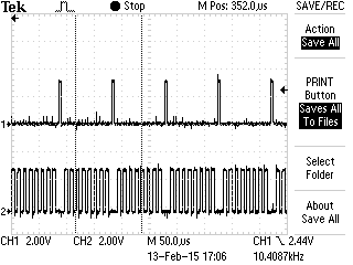

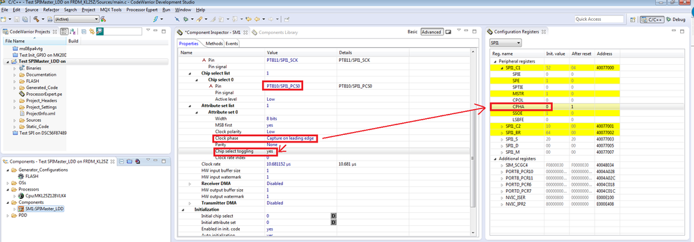

the SS pin toggling depend on the settings of CPHA bit (see the functional description of the SPI in the KL25P80M48SF0RM reference manual). When the CPHA bit is set to 0 the Chip select toggling is enabled and the SPI slave select work according to your requirement. You can see the settings of SPIMaster_LDD component on the following screenshot and the result (signals) on digital osciloscope snapshot (first channel - Chip select pin, second channel clock pin).
I have also attached the application that I have created in CW MCU 10.6.3.

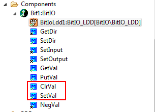

Hi Tom,
The simple method  is configuration the "select pin " as GPIO, when transmit data, configuration it to low ,when not to transmit , high.
Use  the "BitIO" component,  use the "ClrVal" and "SetVal" set the pin to 0 and 1 .

Alice- Yes that works.  But I guess I don't understand the reason the Slave Select setting is in the component if I have to toggle it on my own anyways.
In fact I got rid of the SynchroMaster because it is too slow and went straight to the SPIMaster_LDD component.  The Slave Select is in SPIMaster_LDD as well but the BitIO works as you would expect.

Hi Tom,
About the "chip select toggling " on KL2x family , there is a bug , so I recommend you configuration the pin to GPIO.
The detail introduce you can refer to here :   SPI Chip select toggles between bytes , please see the talking of   xiangjun.rong  .
