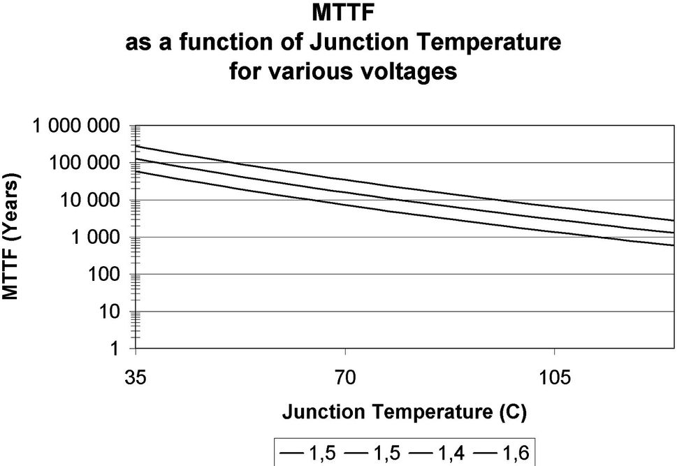

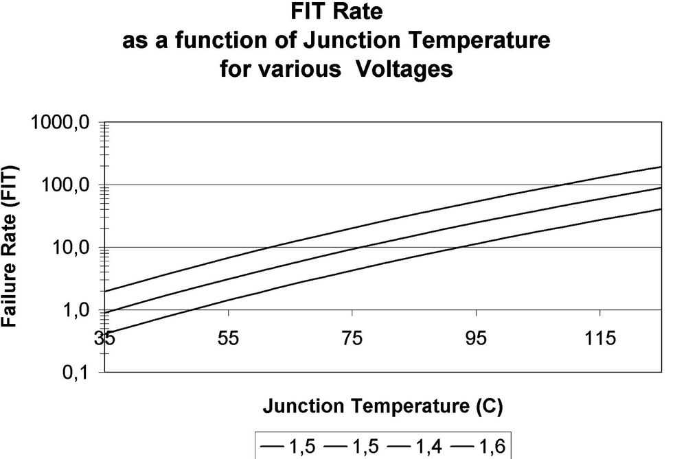

LPP
MTBF for PCF8582C is 3.33E8 Hours upon Tj=55 ºC at use conditions, activation energy of 0.7eV, and a 60% confidence level.
Reliability curves for MPC5200 are below.
